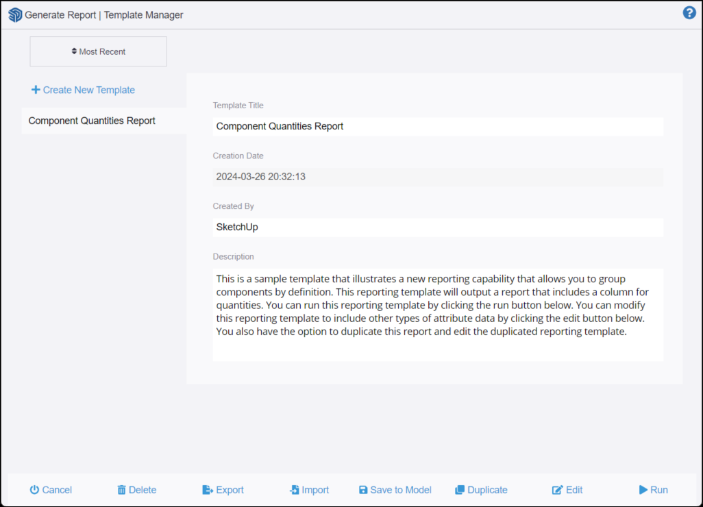

To create a template, follow these steps :
  1. Select File > Generate Report to open the Template Manager.
  2. Click Create New Template or select an existing template to edit.
  3. Choose which options to include in your template. If editing an existing template, adjust the options as needed.
  4. Select your desired filters, columns, and units for your template.
  5. Click Save Changes to save this template to your model. Saved templates can be used again.
  6. Enter a title and description and then click Save to Model, as shown in the following figure. Your template is saved.
  7. If you do not want to save this template, click Run to generate a report without saving.
