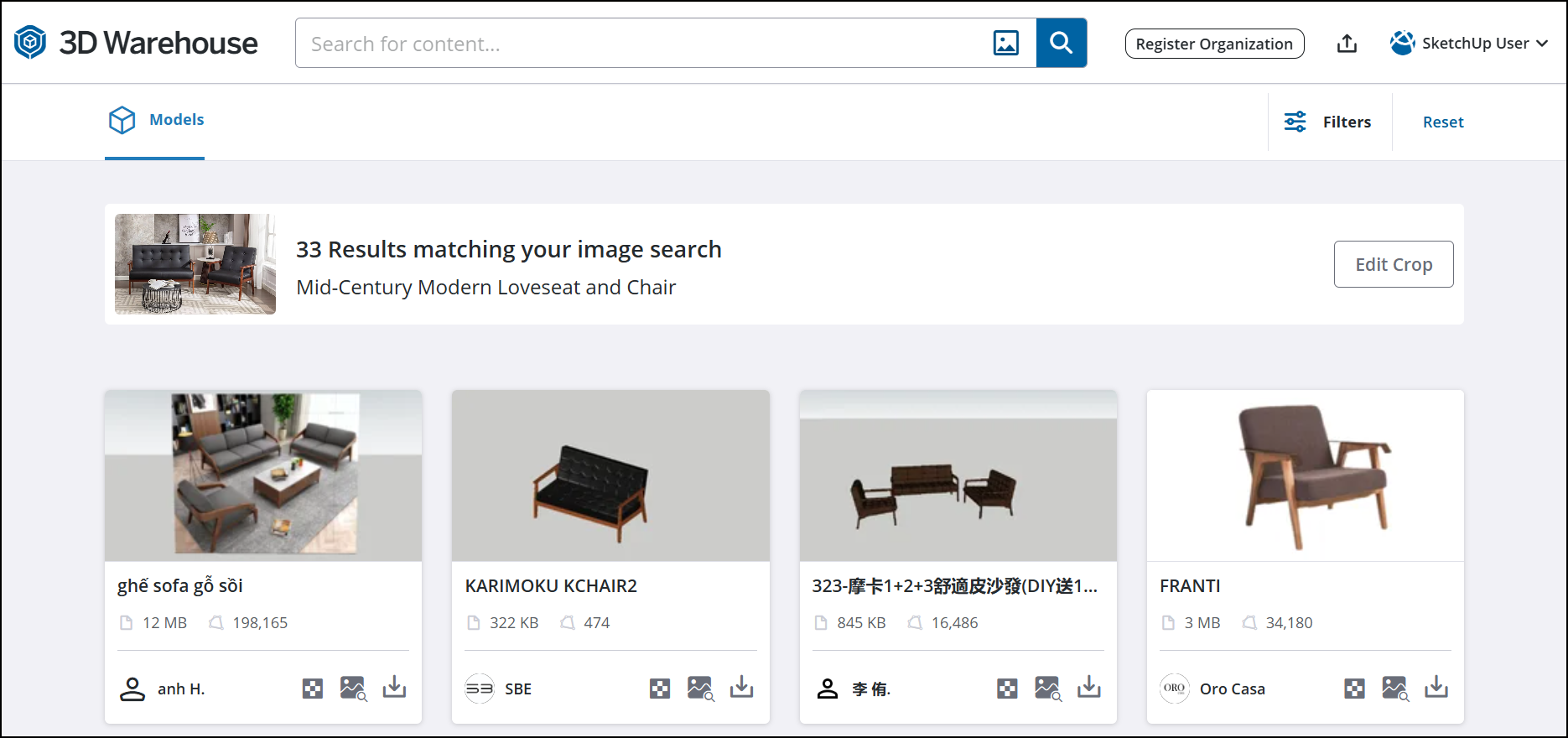

With 3D Warehouse's image search, you can use a reference image to find similar models.
To search using an image:
  1. Click ( 3dw icon image search.png ) in the search box.
  2. In the 3D Warehouse Image Search dialog, use one of the following methods to upload a reference image.
    • Drag-and-drop an image.
    • Browse your device for the image file.
    • Paste an image from your clipboard.
    • Enter a URL for an image.
    3D Warehouse will find the best matches based on your reference image.
  3. Scroll to view the current results.
