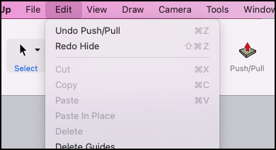

Undo is available under the Edit menu along with a description of the last action you performed. For example, if you last used the Push/Pull tool, you'll see Undo Push/Pull in the Edit menu.
The default keyboard shortcut for Undo is Alt+Backspace . However, Ctrl+Z (Microsoft Windows) or Command+Z (macOS) also work.

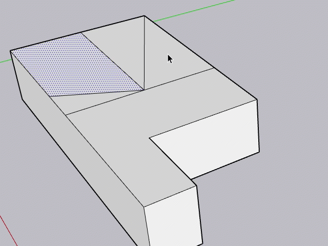

The Erase context command helps you remove selected geometry, including faces. To use the Erase context command:
  • Context-click a face or edge and select Erase from the context menu.
  • To remove multiple edges and faces at the same time, use the Select tool to select the geometry then context-click your selection and choose Erase.
