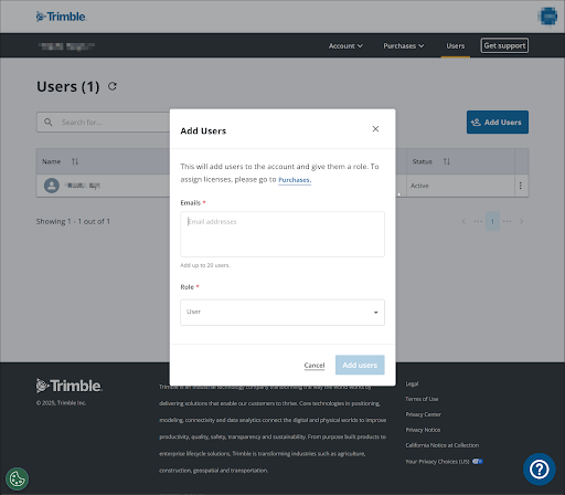

To add users to your account, open the Admin Console and follow these steps:
Click Users in the left pane.
Click Add Users. The Add Users window will appear.
Enter each new user’s email address under Emails. You can add up to 20 users at a time, separating each one with a comma, space or semi-colon.
Under Role select a role. That role will be assigned to each user you are adding. For more information, see Managing Roles.
Under Support Access, Account Owners can choose the level of access the user has to the Trimble Support Center. For more information, see Navigating the Support Center.
After entering all required information, click Add Users. Click Cancel to go back without adding users.
