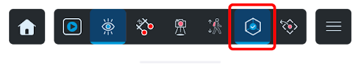

After completing a scan, and anytime you activate Return to Alignment, SketchUp Viewer activates Passthrough mode. SketchUp Viewer locks navigation to prevent any accidental alignment changes. If you need to navigate away from the current position you can always select Return to Alignment on your toolbar to realign your model.
Return to Alignment is only available if you open a model with Spatial Anchors stored and you are in the original scan location that matches those anchors. If the original space has changed, like if furniture was moved, the Spatial Anchors will not match and Return to Alignment will not be available. The Return to Alignment icon changes based on the status of your model:
Icon
Status
Description
Alignment Unavailable
This is the status of the button if:
The opened SketchUp model has not been created with the Scan Space feature.
The user is located in a space other than the one where the model was created.
The spatial anchors cannot be recognized.
Alignment Available
This is the status of the button if the opened SketchUp model includes spatial anchors and the Quest device recognizes that the user is located in the same space where these anchors were originally captured. This status indicates that an alignment is available and the user can align their model to the real world.
Alignment Done
This is the status of the button when Alignment is available and the user chooses to align the model. Once clicked the user automatically enters immersive mode, the model is aligned and navigation remains locked. Clicking the button again unlocks the navigation.

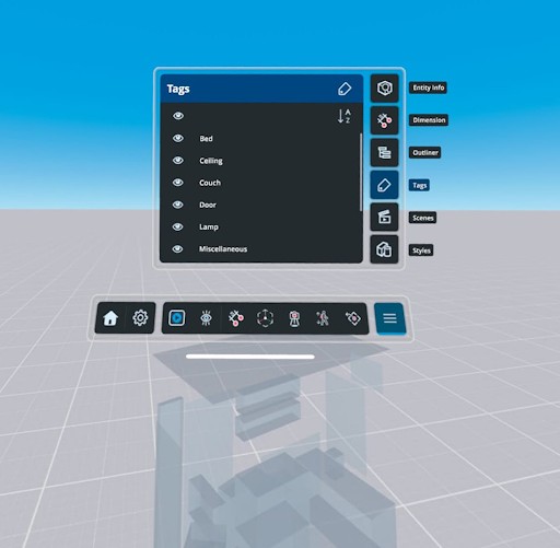

During data conversion, Scan Space automatically groups, names, and organizes scanned elements using Tags.
SketchUp Viewer uses the following tags:
  • Bed
  • Ceiling
  • Couch
  • Door
  • Lamp
  • Miscellaneous
  • Plant
  • Screen
  • Storage
  • Table
  • Wall
  • Wall Art
  • Window
For more information on how Tags work in SketchUp, see Controlling Visibility with Tags .
