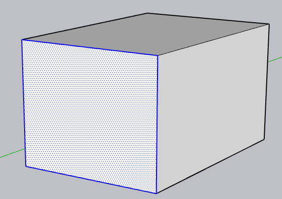

Double-clicking a face...
...selects the face and all bounding edges.

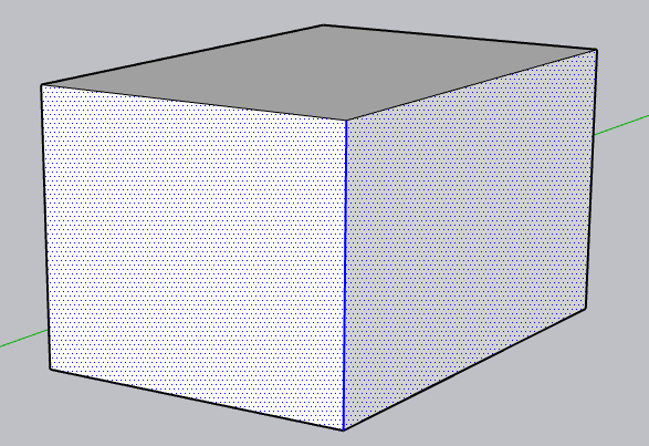

Double-clicking an edge...
... selects that edge and each connected face.

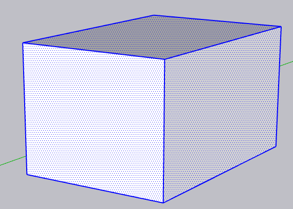

Triple-clicking anywhere on an entity...
... selects all connected entities. For example, if you triple-click a face in a cube, the entire cube is selected.
