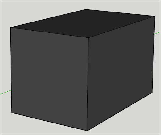

Style: Display in Wireframe Mode
Only displays the lines in a model. Faces are not displayed and you cannot use face modification tools like Push/Pull.

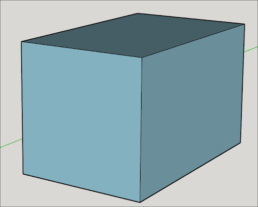

Style: Display in Shaded Mode
Uses basic shading to roughly simulate a light source.

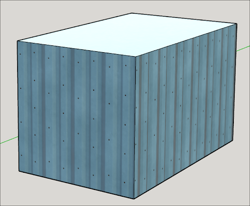

Style: Display Shaded Using Textures Mode
Uses basic shading to roughly simulate a light source interacting with basic textures.

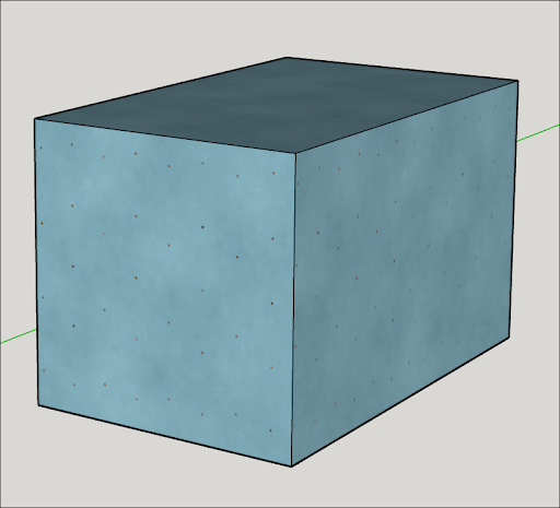

Style: Display Photoreal Materials
Displays faces using the Photoreal Based Rendering (PBR) texture maps assigned to its applied material. An Environment must be selected for PBR materials to display their full effects.
