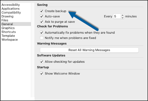

By default, SketchUp creates a backup of all your saved files by default. If you aren’t sure if SketchUp is creating backups, you can check by following these steps:
  1. In the title bar, click Window.
  2. Select Preferences from the dropdown menu.
  3. Click General.
  4. Ensure the checkbox next to Create Backup is selected. If it is not, click the checkbox to enable it.
When Create Backup is selected, Sketchup will automatically create a backup file.
Image of General tab of Preferences with arrow pointing to Create backup
These backups are usually located in the same folder as the original file. On Windows, backups appear with the .skb extension instead of .skp. On MacOS, the file name appears with ~ appended to the end.
