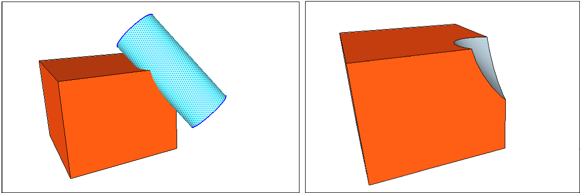

) uses one solid entity to cut another, overlapping solid entity. The geometry used to make the cut is removed from your model.
