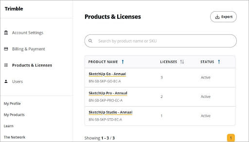

In the left navigation bar, click Products & Licenses.
Select the SketchUp subscription that you want to add licenses to.

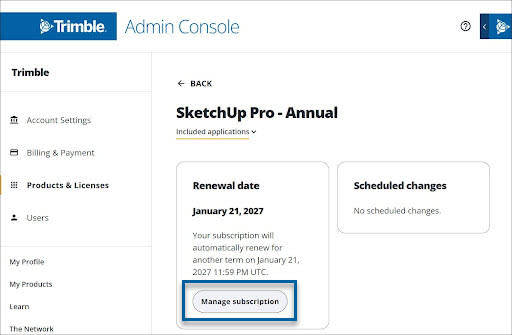

Click Manage Subscription.

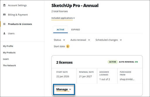

Click Manage to show additional subscription management options.
Megjegyzés: Ha a Close (Bezárás) gombra kattint, ezek a lehetőségek többé nem jelennek meg.

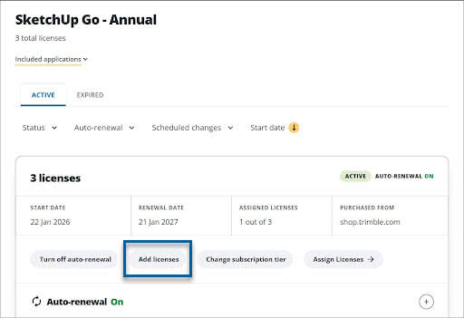

Click Add licenses.

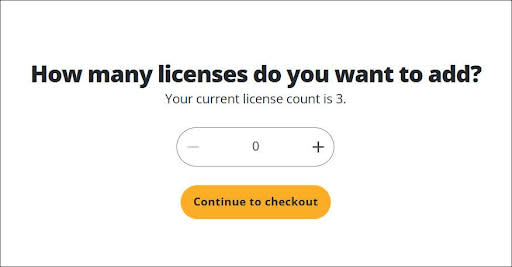

Specify the number of licenses to add.
Click Continue to checkout to pay the prorated amount for your new licenses.
Note: The new licenses will automatically have the same term (monthly or annual) and renewal date as the subscription. You will only be charged a prorated amount for the remainder of the current subscription.
