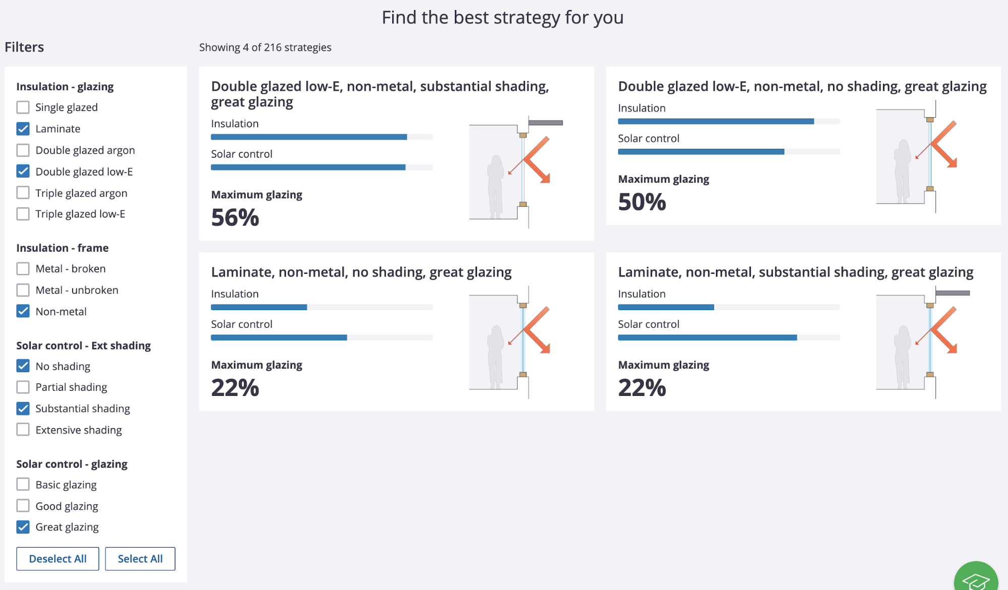

These strategies are found in the glazing ratio feature (see example below).
Why we've used generic names for strategy components.
This feature aims to help associate a recommended maximum amount of glazing by orientation with different facade strategies that might be employed to improve facade performance.
At PreDesign, most projects will not know what specific products they will use. However for many projects, budgeting from the start is important. These strategies can be used to help get a broad idea of the cost and aesthetic implications of using different amounts of glazing on different orientations.
One way to use this feature is to identify what you would need for the target glazing ratio and then use this information to create an outline set of requirements / briefing specification by orientation for your facade.

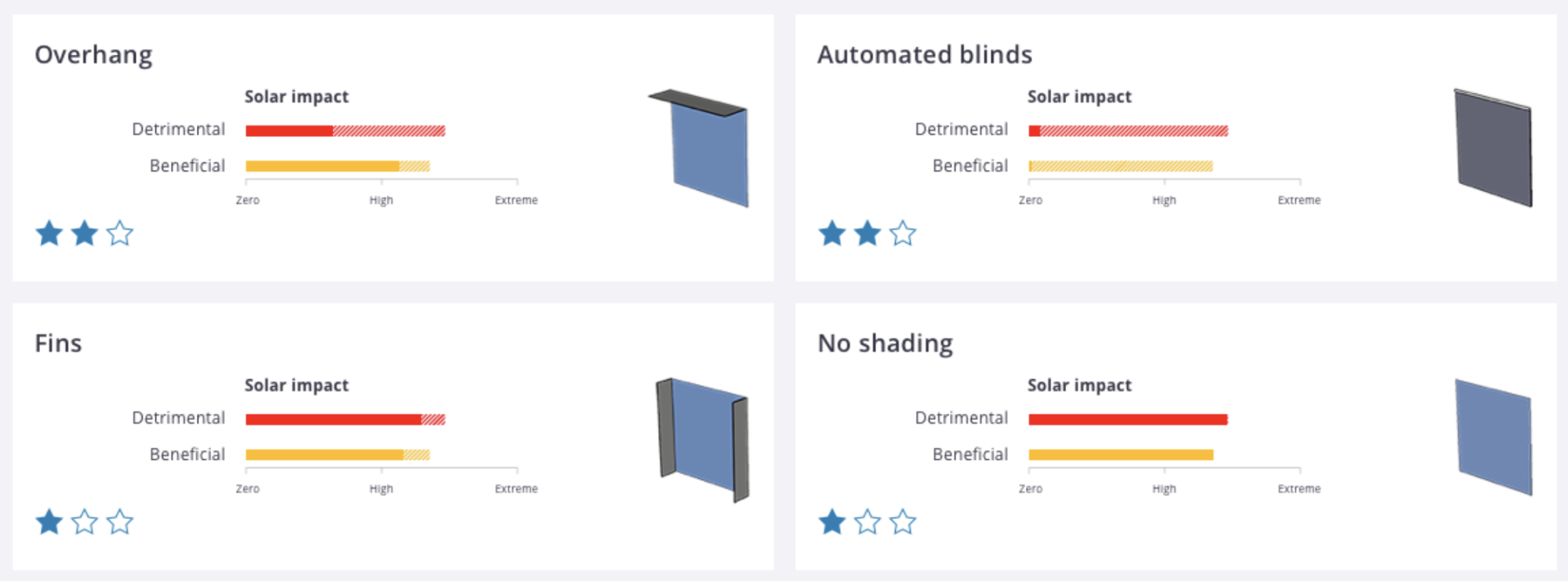

For example, the image below shows 4 different shading strategies on the south facade of a building in Boulder, Colorado.
  • Automated Blinds block more than 75% of overheating sun, so it is considered an extensive shading strategy for this facade.
  • Overhang blocks over 50% of overheating sun, so it's considered a substantial shading strategy.
  • Fins and No shading block less than 25% of overheating sun, so both are considered to be equivalent to no shading.
