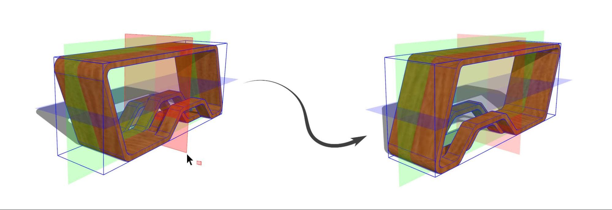

After activating the Flip tool three semi-transparent planes appear corresponding to your selection's cardinal orientation. You can then start flipping your geometry using any of the iPad input methods. The Flip tool works the same when in either Click-Move-Click or Just Draw mode.
Mouse or Trackpad - Hover over then click a plane to flip your selection along that plane. If Copy mode is selected click, hold, and drag a plane to where you want the flipped copy in your model. Releasing your mouse button or trackpad creates a symmetrical copy based on where that plane was placed.
Pencil or Multitouch - Tap a plane to flip your selection along that plane. If Copy mode is selected, tap, hold, then drag a plane to where you want the flipped copy in your model. Lifting your pencil or finger creates a symmetrical copy based on where the plane was placed.
