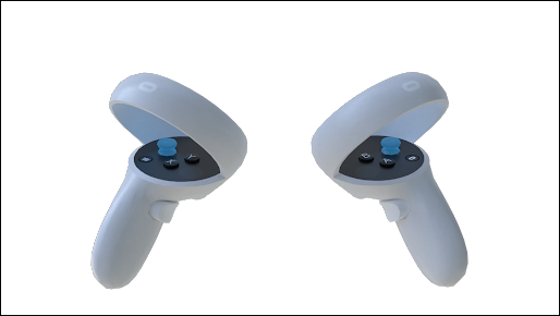

SketchUp Viewer for Quest supports advanced model navigation, taking full advantage of the Quest's controllers.
Navigate with the Quest controllers using a range of gestures using one or both controllers and pressing the grip buttons.
You may also use the thumbsticks on either controller to jump, teleport, turn, and move backwards.

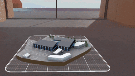

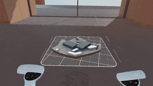

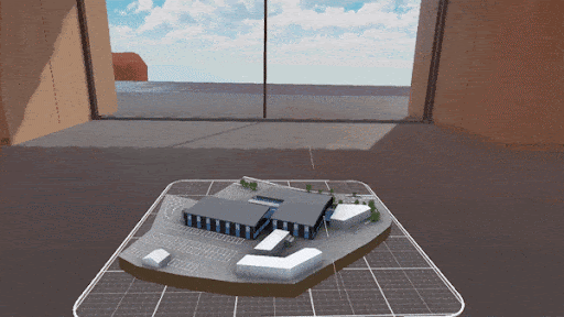

Zoom
You can zoom in or out of a model by:
  1. Point the rays of both controllers at the bounding box of the model.
  2. Hold both grip buttons.
  3. Move your hands apart to zoom in, or close together to zoom out.

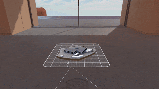

Orbit

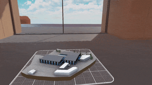

To orbit your model:
  3. Move your hands in a twisting motion, turning your model.
Point the rays outside of the model's bounding box and use the same gesture to look around your model.

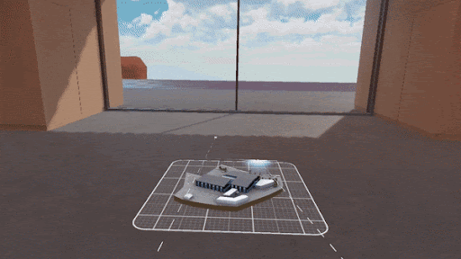

To move a model:
  1. Point the ray from one controller on the model's bounding box.
  2. Hold the grip button.
  3. Move your hand away from the table or floor.
  4. Release the grip. The model maintains its current position and rotation.
If you move a model close to a table or floor surface a blue glow will appear. If you release the grip button when you see the blue glow the model will snap back to the center of that surface.
Repeat the same gesture while pointing at the empty space around your model to pan across the environment without moving your model.

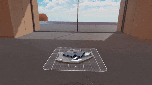

Free Move
You can pick up your model and move it freely about the area using Free Move. Reach out either hand to "touch" the model, then hold the grip button. You can then move your hand away and the model will move with you. The model will also rotate to match your wrist rotations. When you release the grip button the model will maintain its current position and rotation.

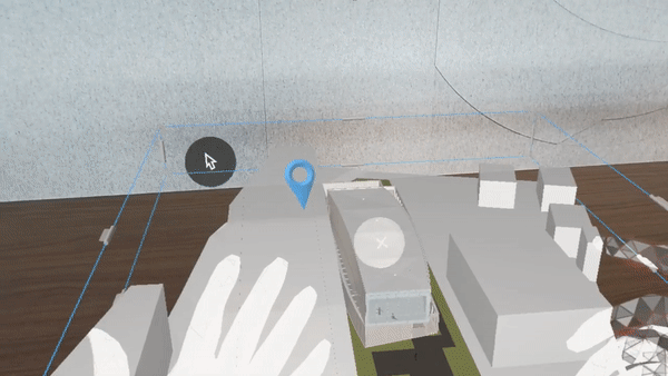

You can also use teleport to jump into your model, switching to immersive mode. Use the same gesture and point at your model, instead of the floor. The circle at the end of the arc should appear with a dashed line with a location icon. When you release the thumbstick you will appear inside your model in immersive mode.
