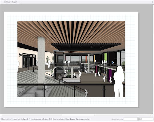

When you choose to send your model to LayOut, a notification will appear prompting you to save your model. LayOut will open and ask you what type of document you would like to create. A viewport containing your model will appear in the new LayOut document.
