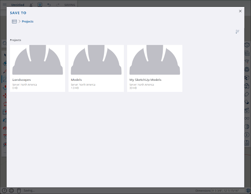

  2. The Trimble Connect window appears. Choose what project you want to save your model in.

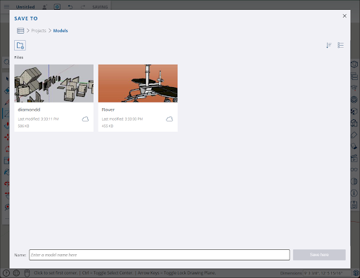

  3. In that project, name your model using the text bar at the bottom of the window and select Save here.
After saving your model for the first time, you can save any progress by clicking Save in the menu bar. We recommend saving manually before closing SketchUp for Web. You can also change the name of a file or overwrite another file using the Save As command in the Main Menu.

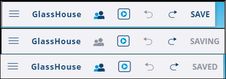

After the first time you save a model in Trimble Connect, SketchUp for Web auto-saves your current model every five minutes by default. Not sure if your model has been saved? Check the Main Menu bar in the upper left.

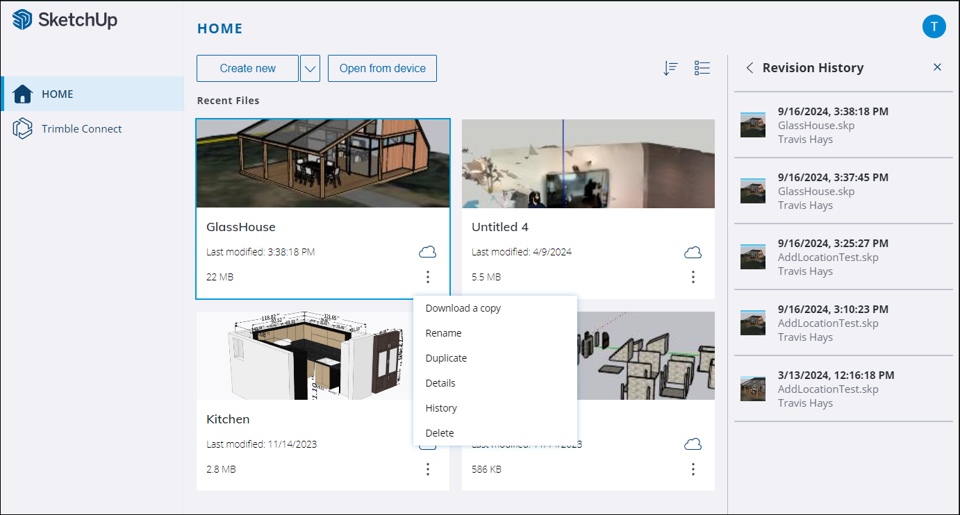

To access revision history for a model, navigate to that model in either the Home tab or in Trimble Connect. Open the file options menu and select History. A sidebar showing each saved older version of your model appears on the right side of the Home page.
Moving the mouse over an older version allows you to open that older version in SketchUp for Web.
When reviewing an older version of a model, any changes are temporary until you manually save the model. When you do save the model, you can choose to restore this version of the model as the current version or save this version as a copy.
