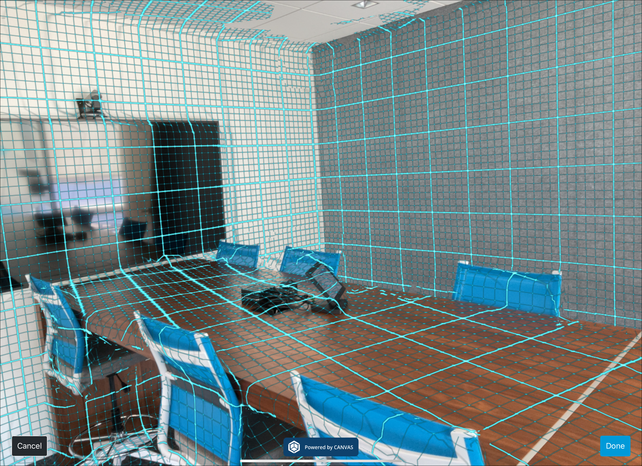

To scan a room:
  • Activate the Scan tool. A scanning grid will appear on your iPad’s screen. SketchUp will offer prompts to help you capture a complete scan.
  • Begin your scan by slowly panning your device up, down, and across the walls around the space. Continue in a steady, patterned motion to make sure you capture every possible detail.
  • While scanning, you can tap Cancel in the lower left corner of the screen at any time to exit the Scan tool.
  • When finished scanning a space, tap Done. Processing can take a few minutes.
  • Review and start modeling using your scanned 3D output.

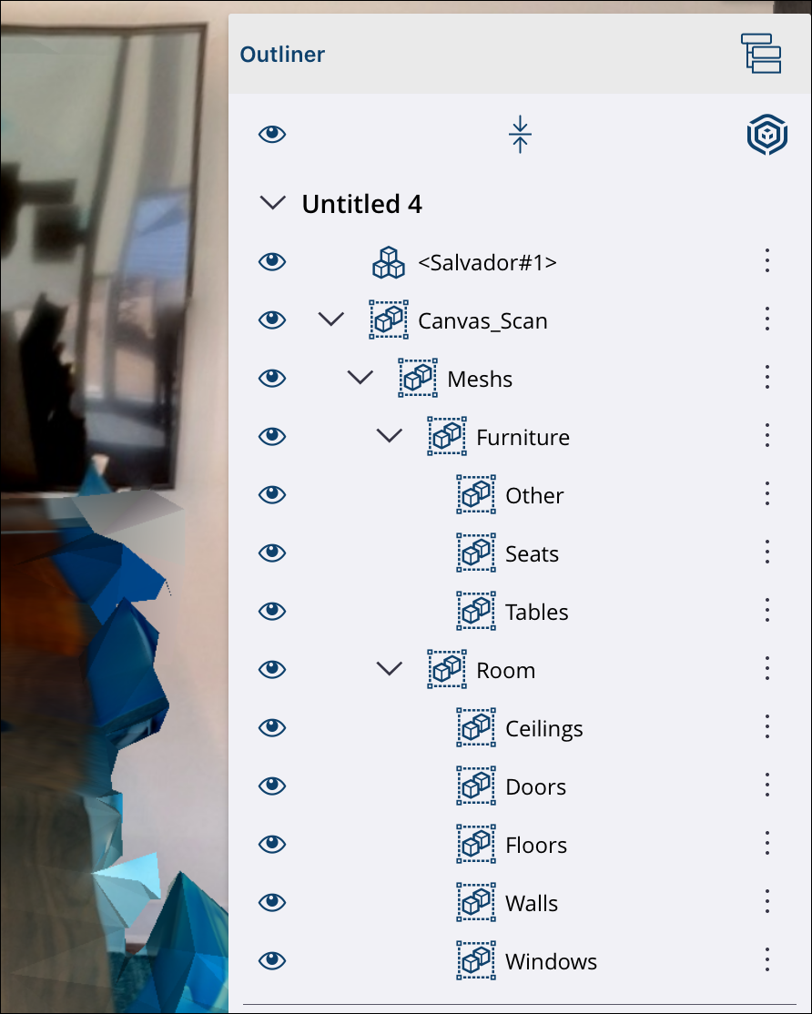

After scanning a space, SketchUp organizes the output imported into your model in the Outliner. For more information on how you can use the Outliner to organize, view, and manage groups and components in your model, see Outliner Panel
