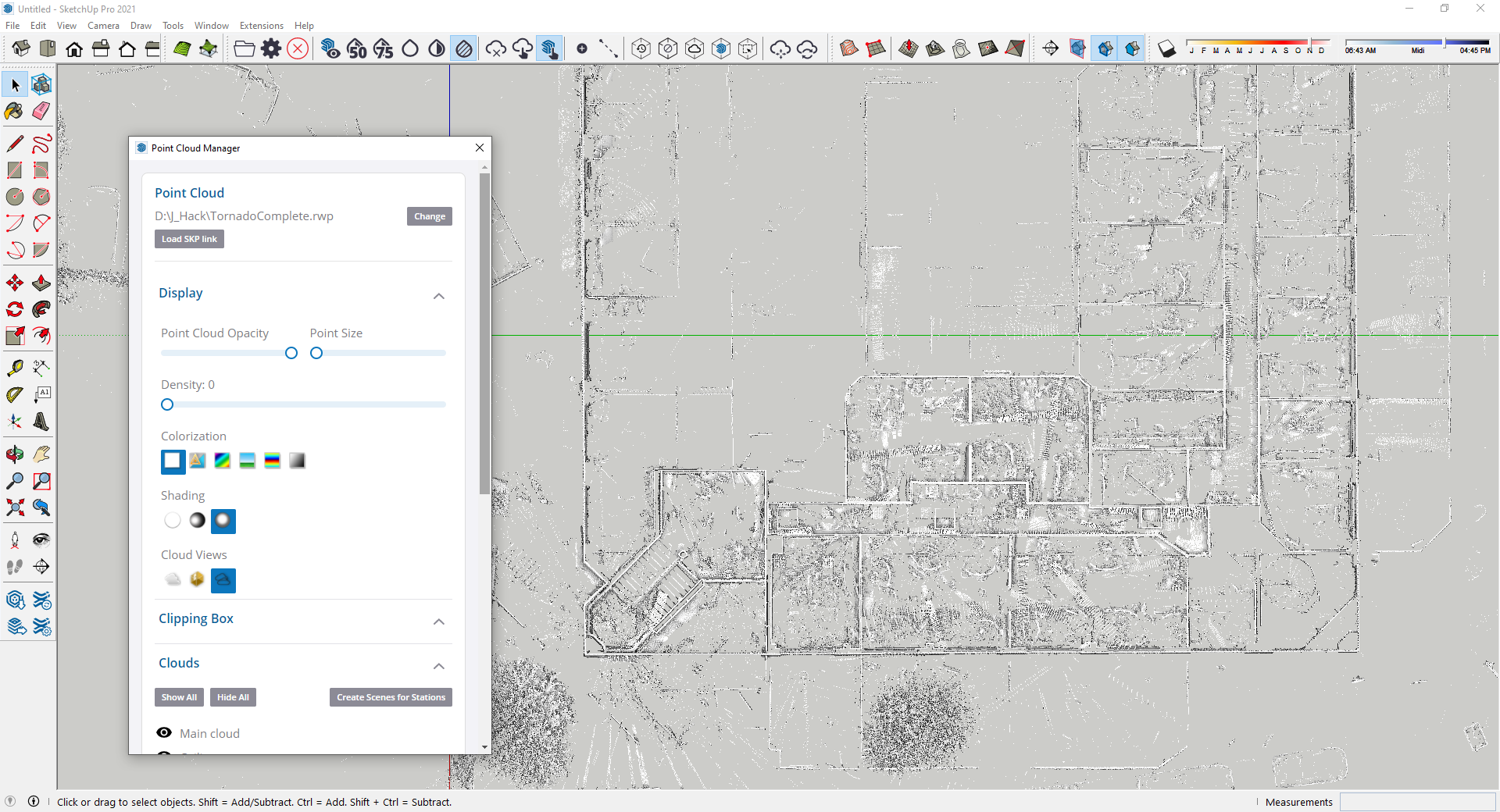

To open the Point Cloud Manager menu, click on the se button point cloud manager.png button. The Point Cloud Manager contains setting options pertaining to how the points in the point cloud will be displayed in the modeling window.

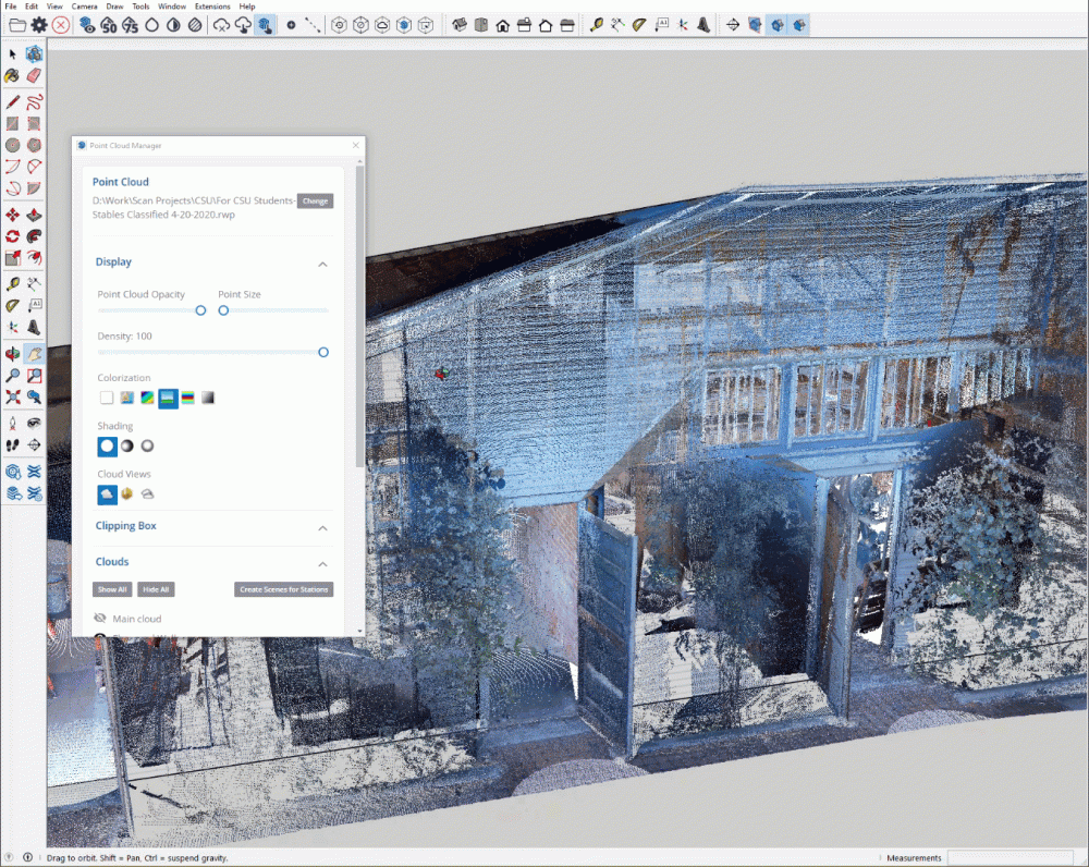

Display

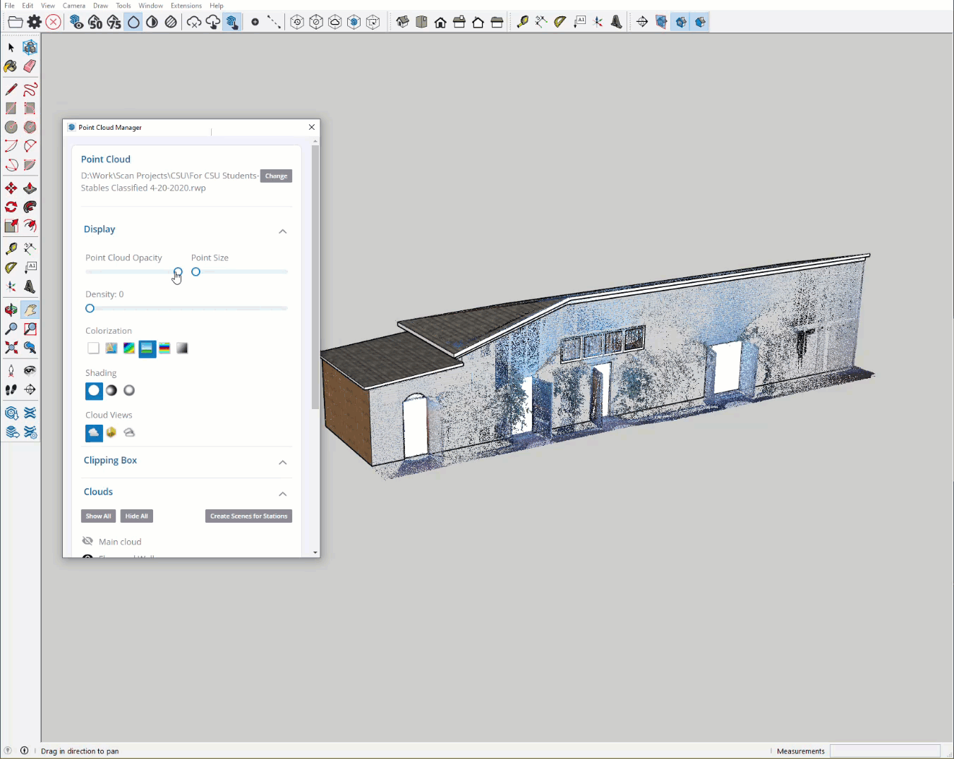

Point Cloud Opacity: Allows you to change the opacity of the point cloud. se display opacity.gif

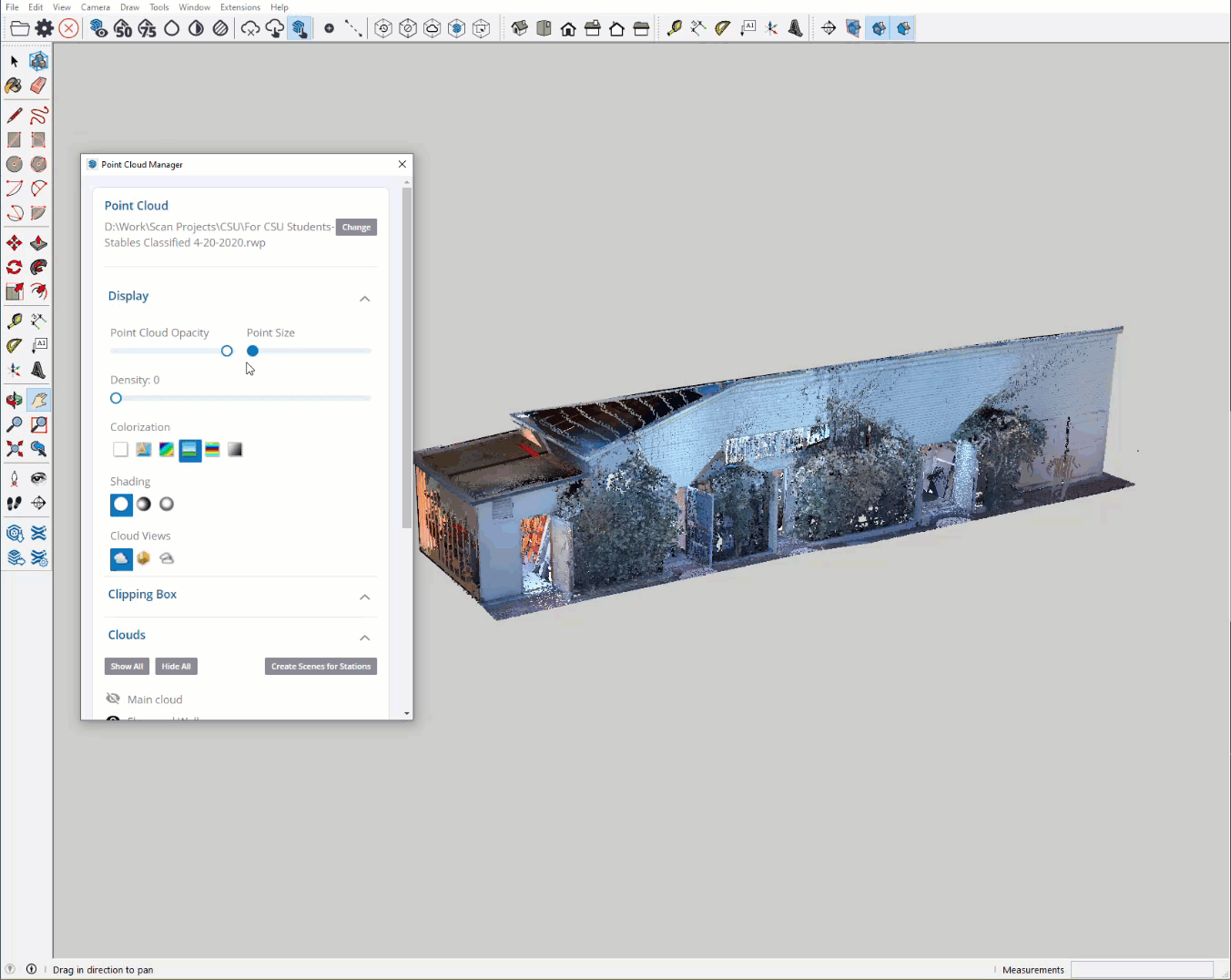

Point Size: Allows you to adjust the size of the points in the point cloud. se display point size.gif
Density: Allows you to change the visualized density of a point cloud as you navigate around the model. Reducing the density decreases the number of points when navigating the model scene and can result in a smoother navigation experience when working with large point clouds. se display density.gif

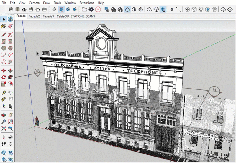

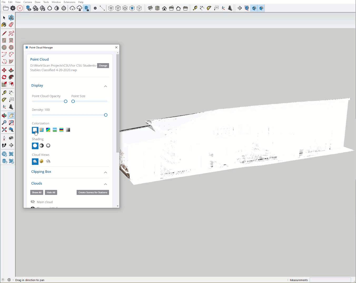

Colorization styles: Allows you to change the color style in which the point cloud is displayed. se colorization styles.gif
White
Station Color
Color Coded Intensity
Color Coded Elevation
True Color
Grey Scaled Intensity

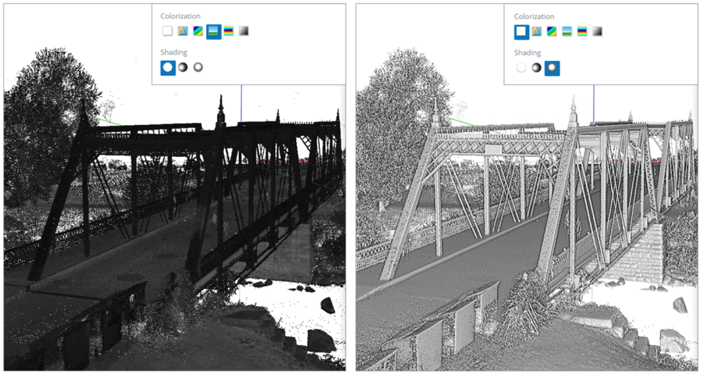

Shading
  • se button no shading.png No Shading - The current colorization style is applied without any shading effect.
  • se button normal shading.png Normal Shading - Point Normal information (when available) is used to alter the output of the current colorization style . Points with a normal perpendicular to the view direction are darkened. Points with a normal facing to the camera are lightened.
  • se button ambient shading.png Ambient Shading - Simulates the amount of ambient light that a point can reflect. When combined with the "White" colorization style, Ambient shading allows you to highlight details for point clouds that do not have any color, normal or intensity information.

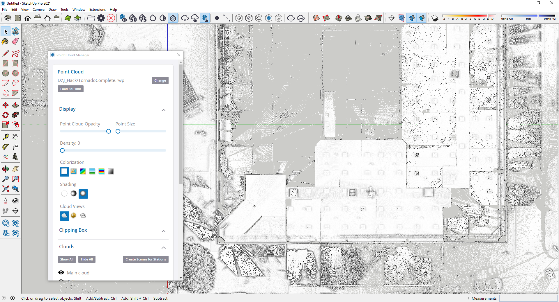

  • se button no filter.png No filter - Displays all the points
  • se button see inside.png See Inside - Allows you to see inside buildings if they were scanned from the indoor. The points that have a normal pointing to the same direction as the view direction are not displayed.

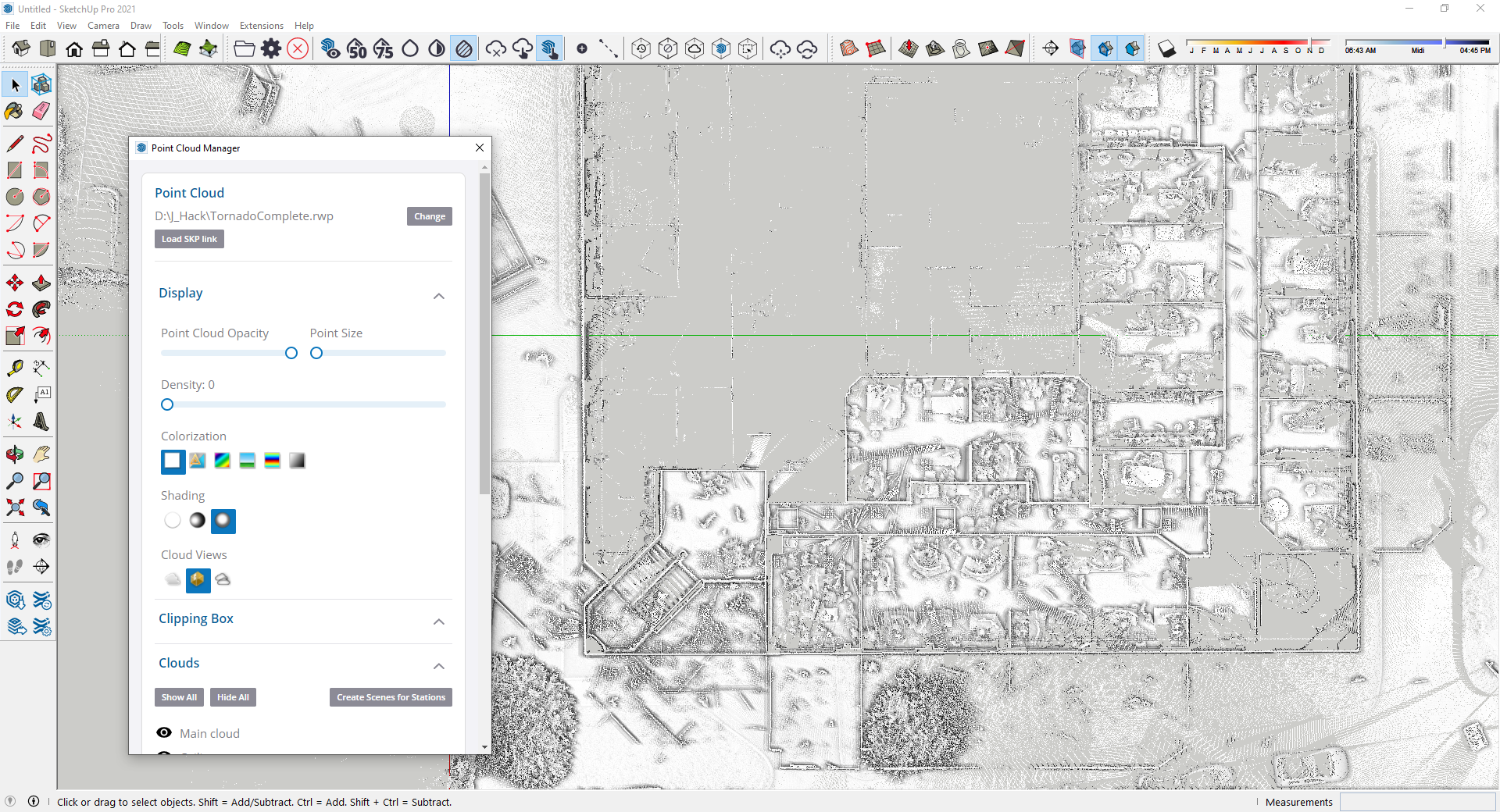

  • se button outline.png Outline - Allows you to see the contours and floor plans of buildings from a top view. The points that have a normal collinear to the view direction are not displayed.

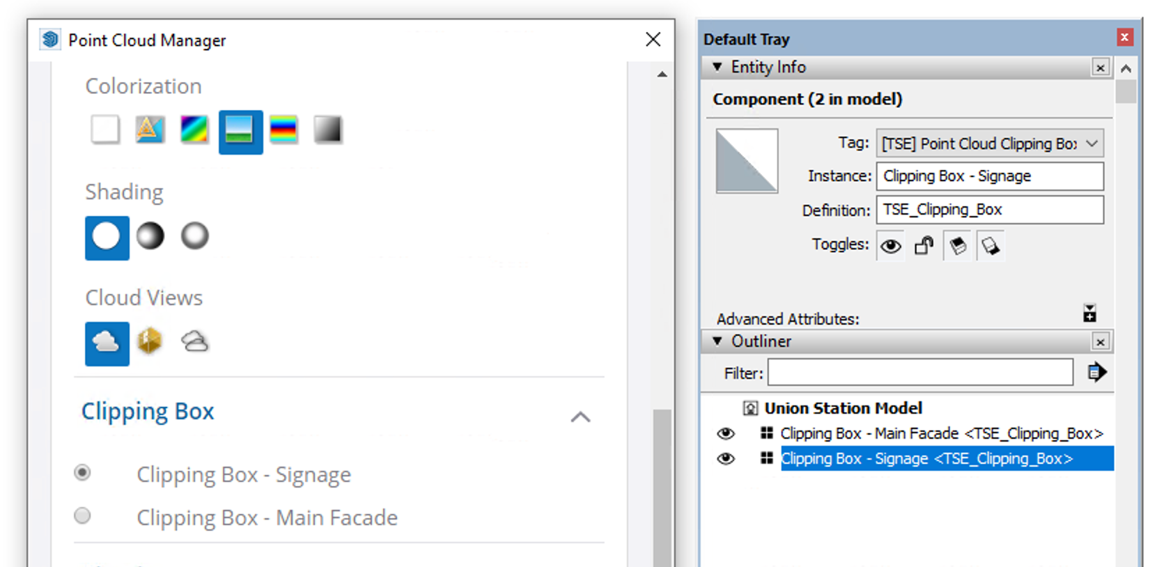

Clipping Box
This area of the Point Cloud Manager contains a list of all the Clipping Box entities created through the Clipping Box Toolset. You can Activate a specific clipping box by selecting one on the list. Clipping boxes can be treated like SketchUp objects allowing you to adjust their location and orientation anywhere in the model.
Tip: References to the clipping box objects can also be found in the Entity Info and Outliner dialogs. Here, they can be activated and also renamed for improved discovery and management.

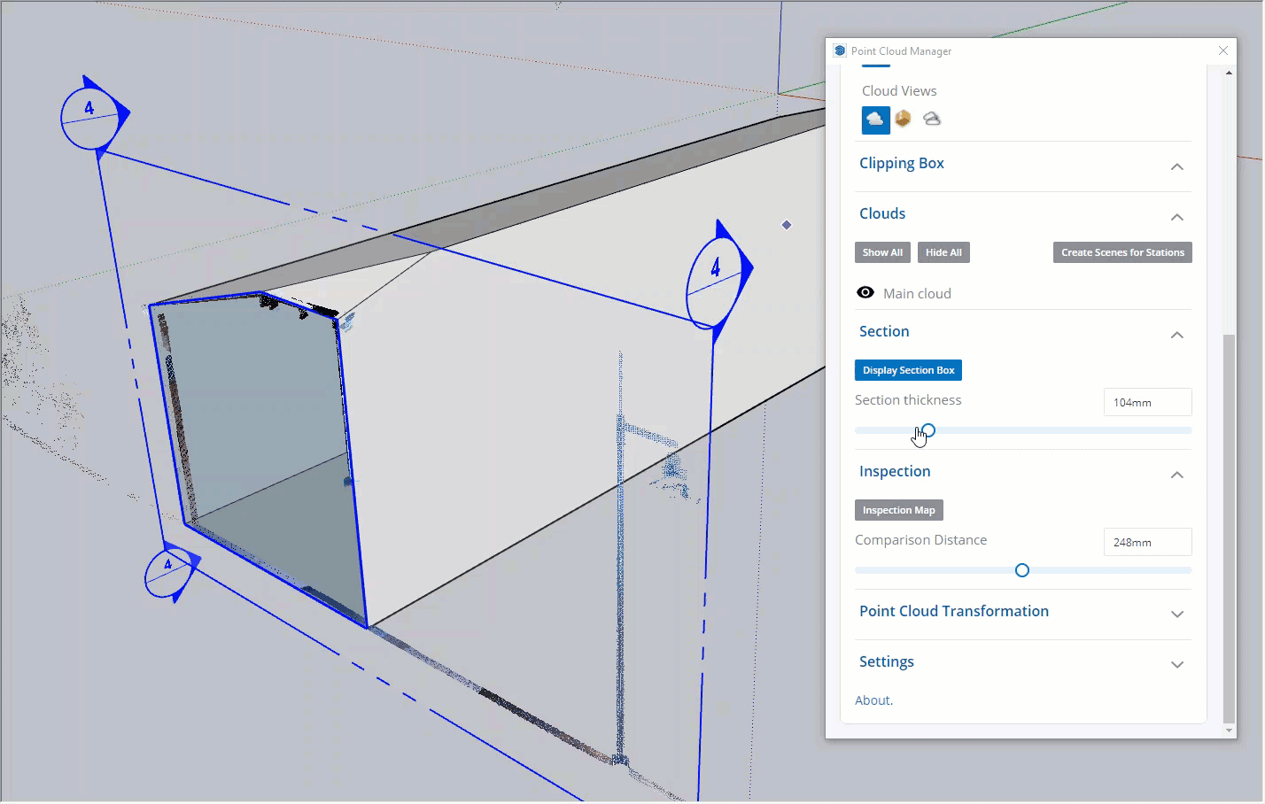

Section Cuts
Large portions of a Point cloud can be removed from view using SketchUp’s native Section tool. The sectioning of the point cloud is determined by the orientation and direction of the active SketchUp section object.
Tip: You can section a point cloud without sectioning SketchUp geometry. Simply toggle the "Display Section Cuts" ( se button display section cuts.png ) to OFF. (Alternatively, Styles window > Edit tab > Section Cuts … unchecked)
The Section settings area of the Point Cloud Manager provides the ability to control the thickness of the points residing along the plane of a section.

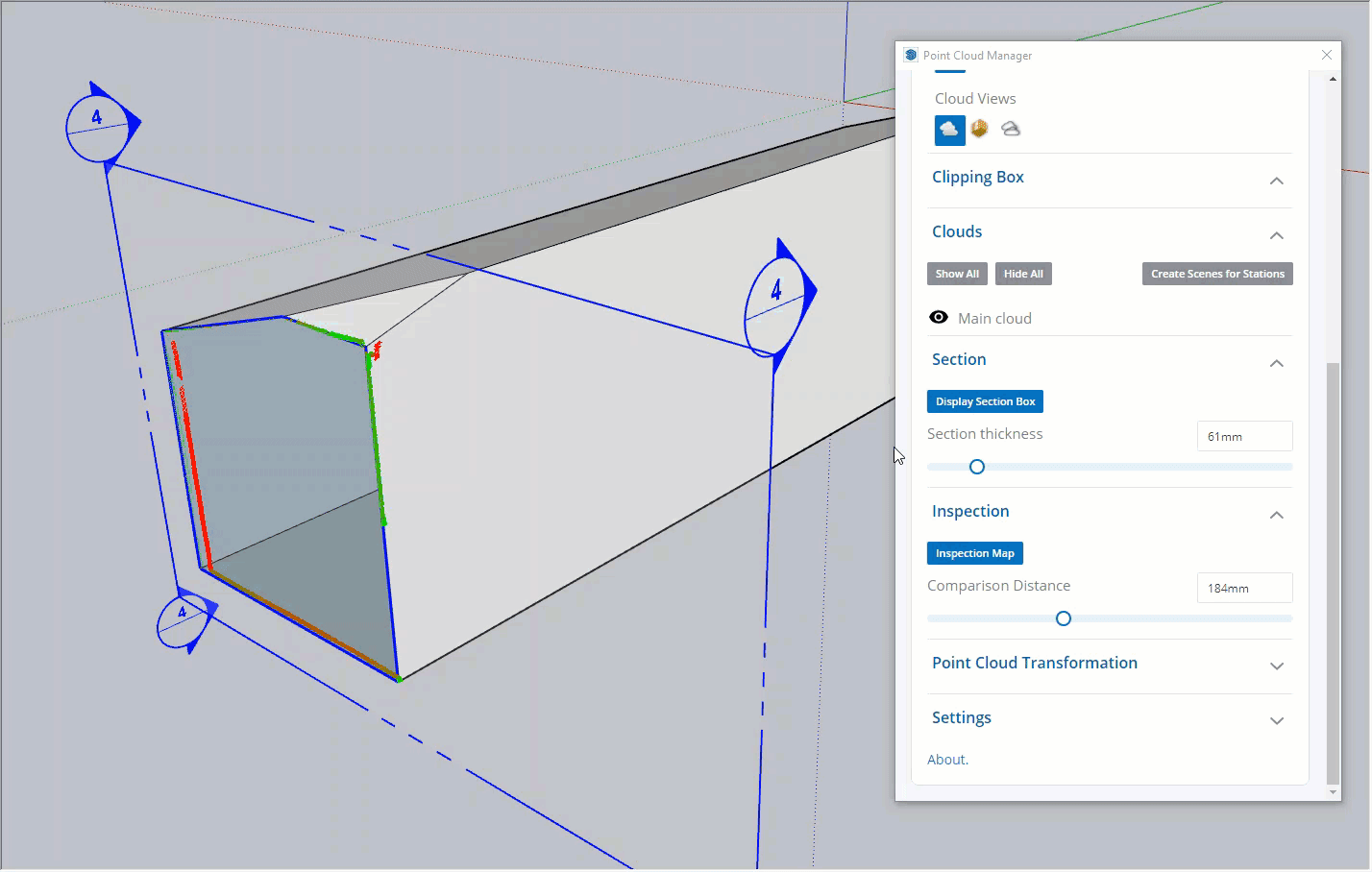

Inspection
The Inspection area allows you to display the point cloud in "Inspection Map" mode. When activated, the point cloud will be colorized to communicate if the neighboring geometry falls in or out of a tolerance distance. Green = In tolerance ; Red = Out of tolerance
The Comparison Distance settings option allows the user to set a tolerance distance (margin of error) between the point cloud and the model geometry.
For more accurate results, align the camera view straight toward the surface needing to be inspected.
