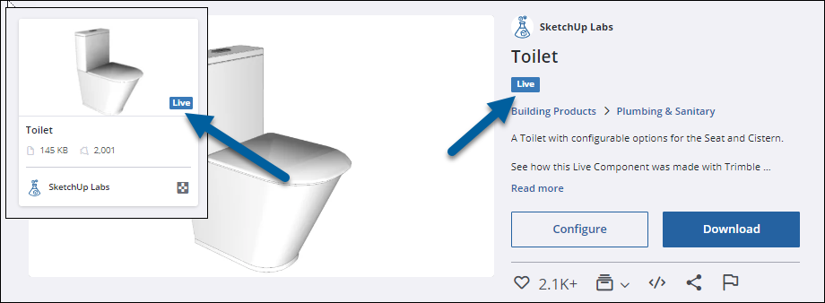

Any Live Component listed in 3D Warehouse will appear with a Live badge in the corner of its thumbnail or under its title in the model’s description.

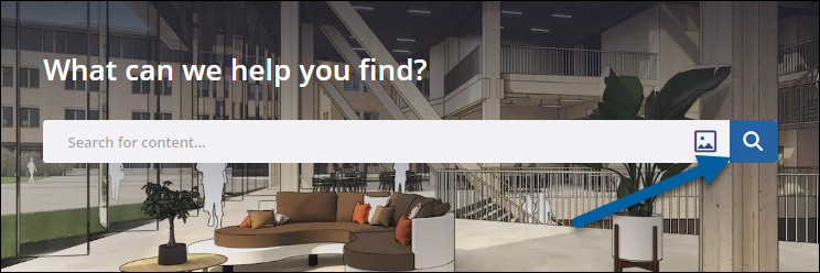

  1. On the 3D Warehouse home page, click Search (Search.png) on the search bar, opening the search results page.

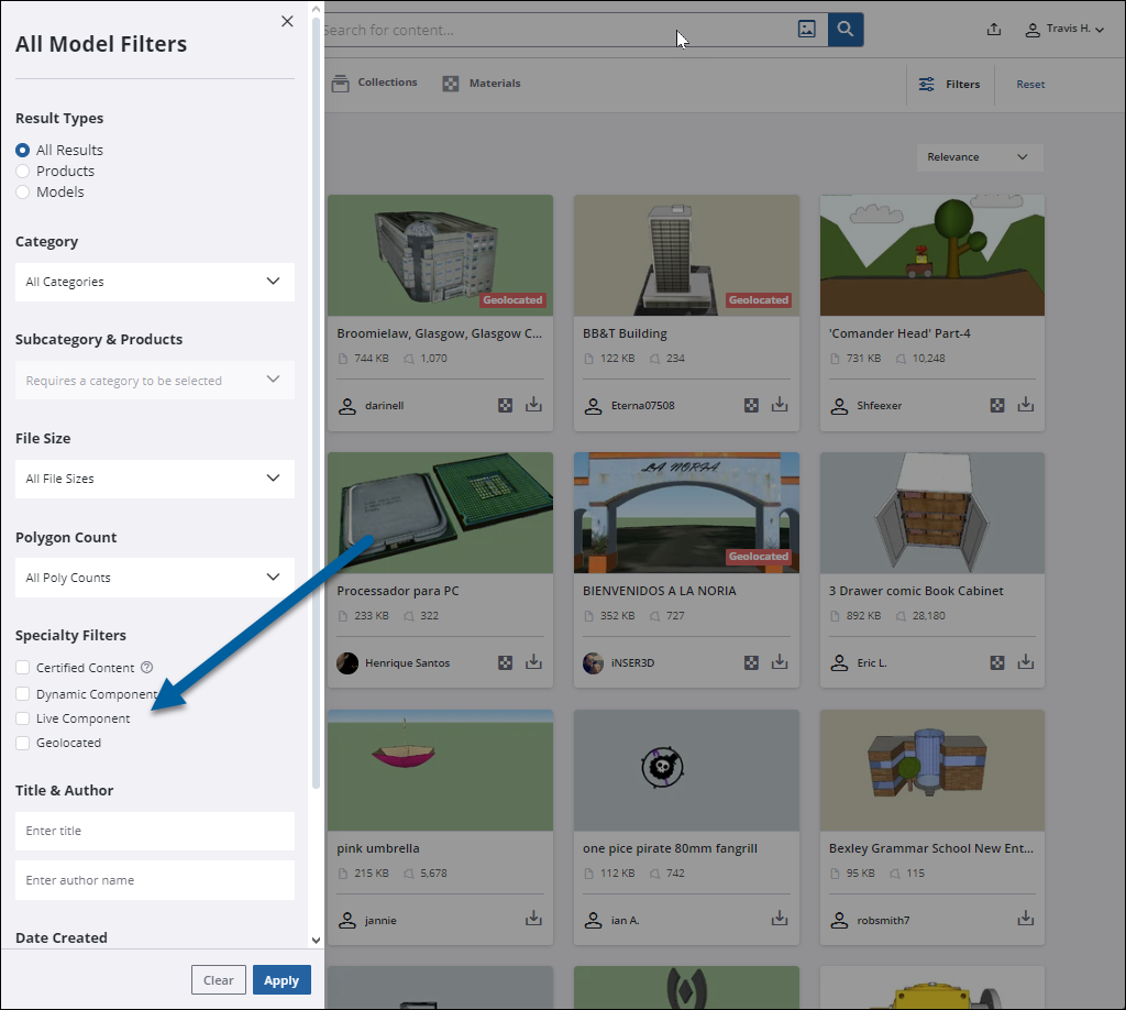

  2. Click Filters. Select the check box next to Live Components in the Speciality Filters section and click Apply. All published Live Components will appear in the Models tab.
  3. Use the search bar at the top of the page to further refine and narrow your search results

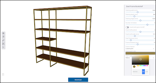

  2. If you need a bit more space, click Expand (SketchUp Creating LiveComponents4.png) to expand the window to full screen. You can also use the Pan, Zoom, and Orbit tools to navigate around the model.
  3. In the Configure panel, adjust the sliders, fields, and other options for the selected Live Component. These options will vary based on the nature of the component. As you adjust these settings, the model updates in real time.
  4. If you are satisfied with the component’s configuration, click Download under the model’s description to save the component as a .skp file.

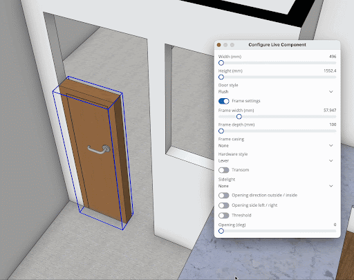

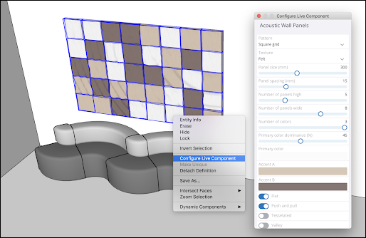

If you are accessing 3D Warehouse from within SketchUp, you can load a Live Component directly into your model. You can also import a Live Component you’ve previously downloaded. Once you’ve added a Live Component to your model, you can configure it by choosing Configure Live Component from the component’s context menu or double-clicking the component.
