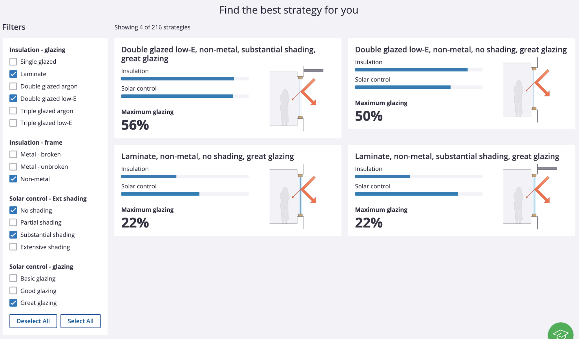

In the Glazing Ratio feature, each strategy is given a score with a recommended maximum glazing ratio, shown as a percentage. See below for an example - the 4 strategies here have maximum ratios ranging from 22% to 56%. Note the options are always ranked highest to lowest in the way they are presented.

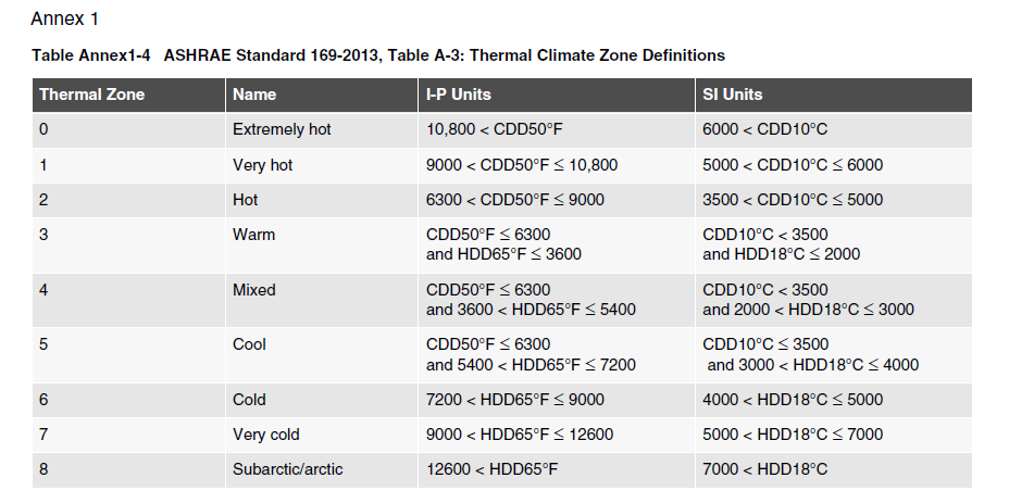

Climate zones
Calculated from ASHRAE Standard 169-2013. See table below.
