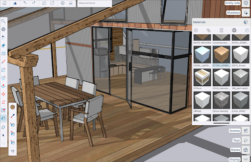

The Paint Bucket tool ( go icon paint bucket.png ) helps bring your models to life using materials. The Paint Bucket tool works with the Materials panel . Activating the Paint Bucket tool opens the Materials panel allowing you to choose the color or texture you would like to add to your model. SketchUp’s default materials offer a variety of colors along with textures that include photobased rendering texture maps.

iPad Input Methods for the Paint Bucket Tool
After choosing the Paint Bucket tool and activating any optional tool modes, you can use your preferred iPad input method in either Click-Move-Click or Just Draw mode.
All Input Methods - Select a material from the Materials panel and either tap or click to apply that material to your geometry.
