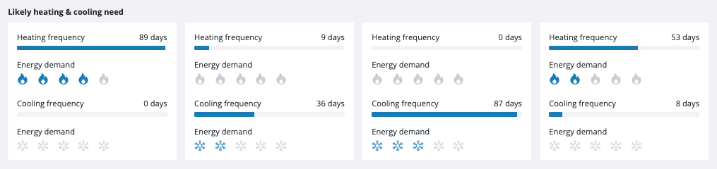

In any PreDesign study, you'll notice that there is information about the likely heating and cooling need for a study that looks something like this:
In this help article, we'll explore how to use this and where the information comes from.

To help with this, the information provides, seasonally, 2 pieces of information:
  1. Frequency of heating and cooling. This is how many days that season the heating or cooling would typically need to be switched on with a standard design
  2. Energy Demand. This offers a relative assessment by season as to how much energy is likely to be needed for heating and/or cooling.
Some ways to think about this information:
  • Each level of improvement in insulation or air-tightness can take a flame away from each season. So if you have flames in each season, small improvements in insulation might have a much bigger bang for their buck than really big improvements.
  • Each level of improvement in shading and/or glazing control or reduction in glazing ratio can be assumed to take a snowflake away from each season. Again, smaller improvements will have a really big impact when you see snowflakes in multiple seasons.
  • Frequency of heating or cooling helps you see how concentrated the demand for heating or cooling is. If the frequency is low, it might be an opportunity to discuss whether systems are necessary, or whether the client should consider temporary options.
