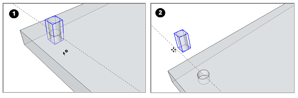

The Trim tool (
) uses one solid entity to cut another, overlapping entity. The geometry used to make the cut remains in your model as a separate solid.

Mouse or Trackpad - Select the Trim tool and click your first solid, then click your second solid.
Pencil or Multitouch - Select the Trim tool and tap your first solid, then tap your second solid.
For more information on how to use the Trim tool in your models, see Trimming one solid with another in Modeling Complex 3D Shapes with the Solid Tools .
