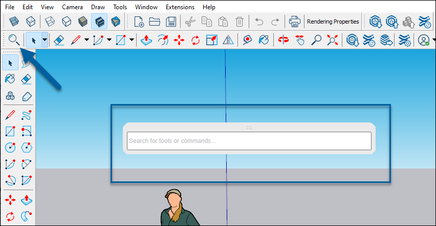

The Search tool appears by default on the left side of the Getting Started toolbar. You can also activate search using its keyboard shortcut, Shift + S, or from the Help menu.
When you activate the Search tool a text box appears where you can type in what you are looking for. SketchUp finds matches as you type. The more you type, the more refined your results will be. SketchUp's Search tool can help you:

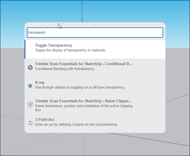

For example, if you are trying to figure out how you can make geometry transparent in your model you may type 'transparent' as your search term. SketchUp will provide you with results that can help you make parts of your model transparent.
