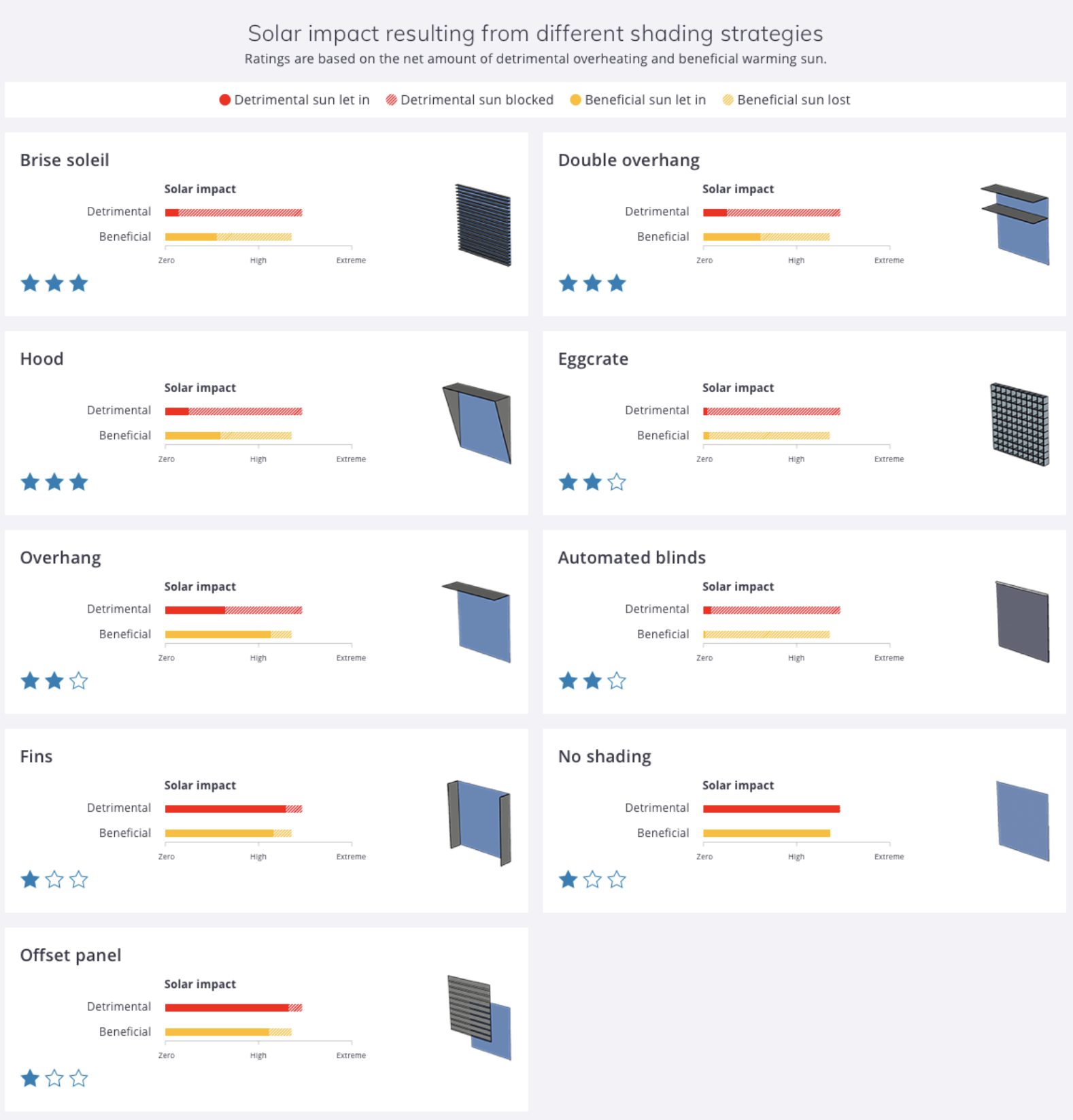

There are nine different shading strategies that are offered in PreDesign. The strategies are always the same, representing options with the same dimensions. Although the options are always fixed, the intent here is to present a guide to help see how different strategies work in general, so the relative sky coverage and effectiveness of different approaches can be assessed.
Generally speaking, if a solution is not presenting well as a strategy in the results, optimisation of the strategy is unlikely to make a substantial improvement.

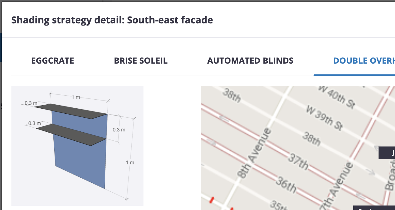

The dimensions for each of the strategies can be discovered by clicking on the strategy card. This opens an overlay window with the strategy and dimensions. An example is shown below. Dimensions are provided in both metric and IP units, depending on your setting.

So for example, with the double overhang above, if the window was 2m high instead of 1m high, a proportionately equivalent solution would have either:
  • 2 horizontal fins 1m wide and 0.6m deep, spaced 0.6m apart
OR
  • 4 horizontal fins 1m wide and 0.3m deep spaced 0.3m apart

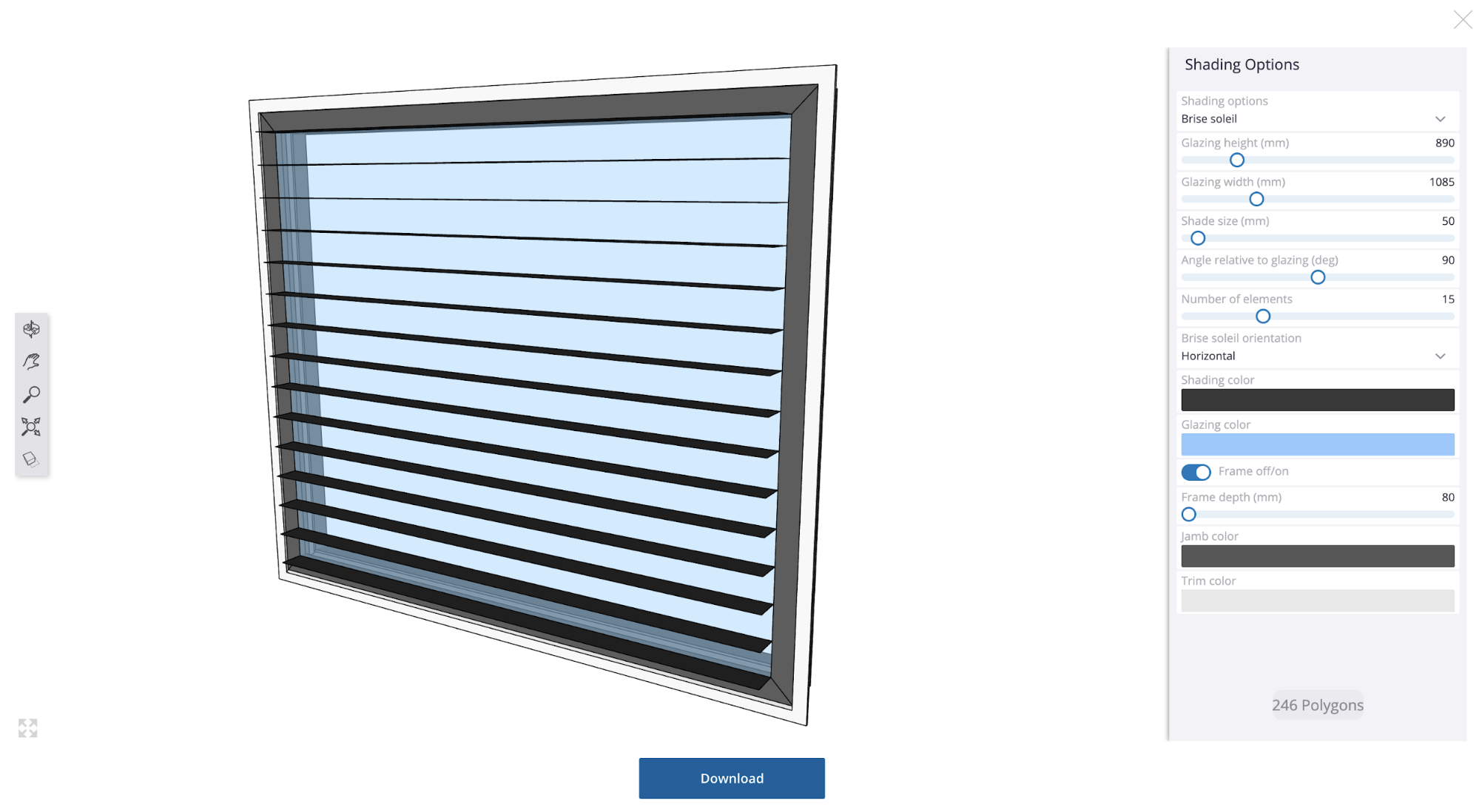

Downloading a live shading component into your SketchUp model
In November 2021 we started to make live components available in 3D Warehouse. One of the live components created was a shaded window that could be adjusted to match all of the PreDesign options and supplemental tweaks you may want to make.
This link takes you to the 3DW live shading component.
The usefulness of this is the component can be used for windows in a massing model and then the shading strategy can quickly be changed across the whole model to see how the different variations would look.
It can also be accessed from SketchUp via the instructions in this forum post .
