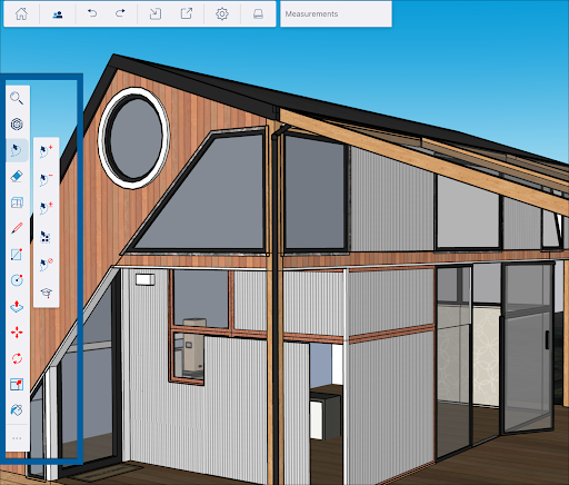

The Main Toolbar appears on the left side of the SketchUp interface and contains the most common tools used when creating models.
The first options seen in the Main Toolbar are Search ( icon search.png ) and 3D Warehouse ( go icon 3dwarehouse.png ). For more information on how these options work, see Searching with the Omnibar or Getting Starte with 3D Warehouse .
The rest of the toolbar contains the following tools:
