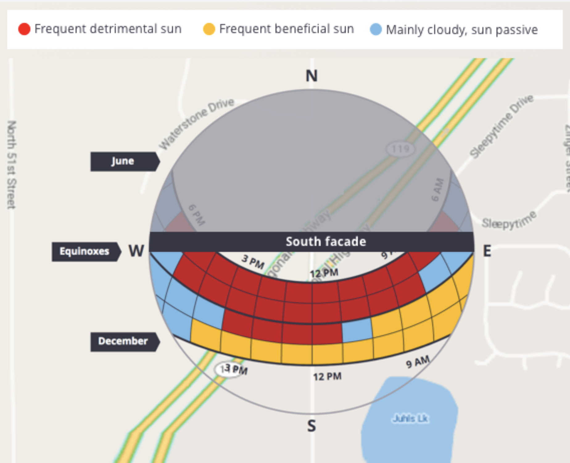

Characterising Sun Patches
The sun path diagram used in the shading feature is “simplified” into areas of a common sun position that we refer to as patches. The patches are used to make it easier to visualise the trends in sun quality over the year on a sun path and also easier to visualise the impact of different shading strategies.
The patches shown in the sun path each represent a “Set” of approximately 90 different days (at the same time of the day) where the sun is in approximately the same position in the sky.
These patches are characterised based on the sum of Overheating Degree Hours and Warming Degree Hours for all time steps in the patch as follows:
Sky Patch Overheating Degree Hours Total
Sky Patch Warming Degree Hours Total (absolute value)
Patch characteristic
>500 degC.h
Any
Detrimental Overheating
>=200 degC.h, <500
=< SkyPatch Overheating Degree hours Total
>=200 degC.h, <500
> SkyPatch Overheating Degree Hours Total
Beneficial Warming
<200 degC.h
>=200 degC.h
Beneficial Warming
<200
<200
Passive

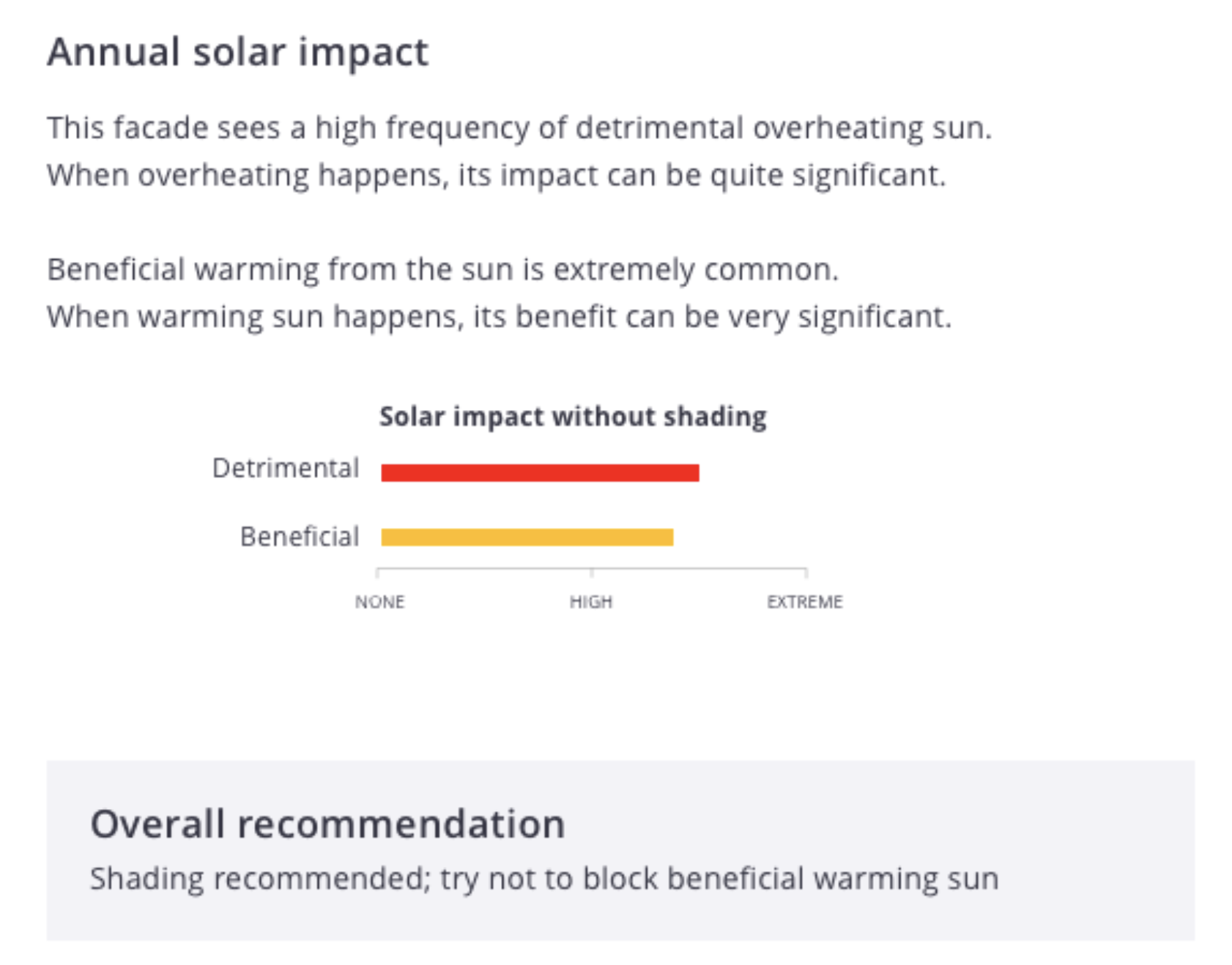

Although patches are used to help visualise trends over the year on a sun path diagram, the actual recommendations of the need for shading and star ratings for each of the shading options are carried out on an hourly basis.
In the summary view of the shading page, we publish some information including a shading recommendation (example below).

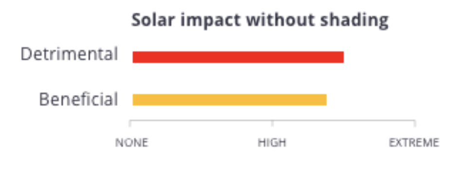

To calculate this, for each time step we do the following:
  1. Start with the Degree-hours of overheating or warming in that time-step.
  2. Modify the value based on the angle of incidence of the sun on the facade (time-steps where the sun is behind the facade count as zero).
This results in:
  1. Total Overheating Degree hours for each typical facade orientation (the sum of each hourly value) over the course of the year.
  2. Total Warming Degree hours for each typical facade orientation (the sum of each hourly value) over the course of the year.
These two values are communicated on this chart in the summary view.
The scale is fixed, with Extreme being equivalent to 5,000 degree hours and High equivalent to 2,500 degree hours.

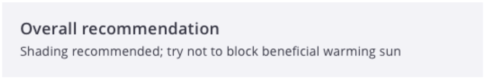

An overall shading recommendation looks like this:
The table below summarises how we use these values to make a shading recommendation for each facade:
Shading Recommendation logic.
Total warming degree hours on the facade
≤ 1,000
> 1,000
Total Overheating degree hours on the facade
≤ 500
Shading not needed.
Embrace beneficial warming sun; avoid shading.
> 500, ≤1000
Shading benefits limited; use glazing with good solar control.
> 1,000, ≤2,000
Consider shading or glazing with good solar control.
Consider shading; try not to block beneficial warming sun.
> 2,000, ≤4,000
Shading recommended
Shading recommended; try not to block beneficial warming sun.
> 4,000
Shading strongly recommended
Shading strongly recommended; try not to block beneficial warming sun.

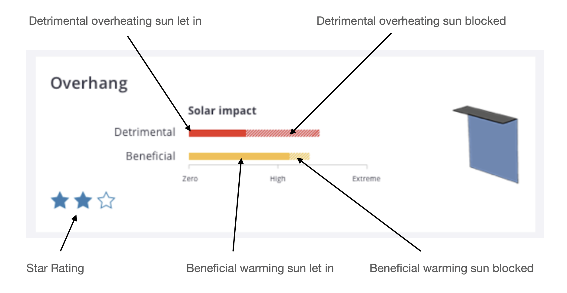

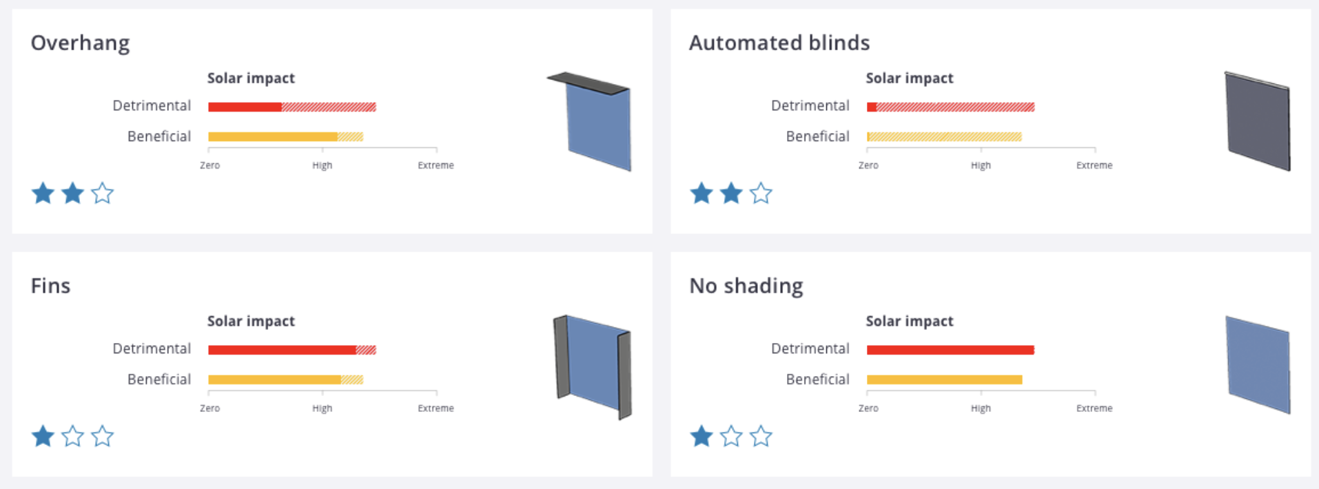

How Shading Options are scored
Shading options are presented in PreDesign as shown below.
For each shading option, at each time step we then
  1. Identify the % of the glazing that is shaded from the sun at that time step
  2. Note the resulting Degree hours overheating or warming sun shaded for that time step and the resulting degree hours overheating or warming sun let in for that time step.
This gives us for each shading option:
  1. Total Overheating Degree hours blocked by the shading option for each typical facade orientation (the sum of each hourly value) over the course of the year.
  2. Total Overheating Degree hours let in by the shading option for each typical facade orientation (the sum of each hourly value) over the course of the year.
  3. Total Warming Degree hours lost (ie blocked) for each typical facade orientation (the sum of each hourly value) over the course of the year.
  4. Total Warming Degree hours let in for each typical facade orientation (the sum of each hourly value) over the course of the year
The star rating for the option is based purely on the amount of overheating and warming sun blocked by the shading device.
final score = overheating degree hours blocked -0.5 ( warming degree hours blocked)
For no shading, the equation is slightly different and based solely on the unshaded amounts:
final score = 2,000- overheating degree hours let in +0.5 ( warming degree hours let in)
