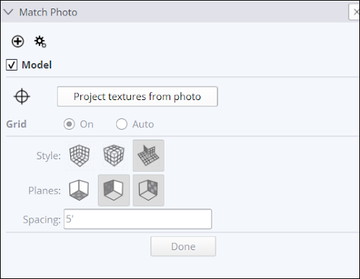

  3. The Match Photo panel will open. Use the panel to change the style, planes or spacing of your photo. desktop match photo popup.png

  5. (Optional) Unselect Model in the Match Photo panel to hide your model from view. Removing your model can help when lining up the vanishing point bars.
