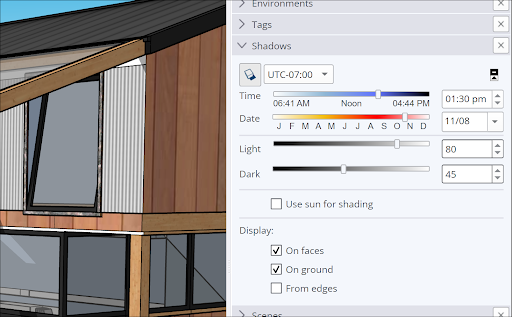

To change the way shadows appear in your model, open the Shadows panel and adjust the following settings:
  • Show/Hide Shadows – Toggle shadows on or off.
  • Time and Date – Use the sliders and dropdown menus to select the time and date SketchUp will use to cast your shadows.
  • Light and Dark – Use the sliders and dropdown menus to adjust the intensity of light and dark when casting shadows.
  • Use Sun for Shading – When selected, SketchUp's simulated sun shades parts of your model even with shadows toggled off.
  • On Faces – Faces in your model will cast shadows on other faces. Unchecking this option can improve performance.
  • On Ground – Geometry casts shadows on the ground plane.
