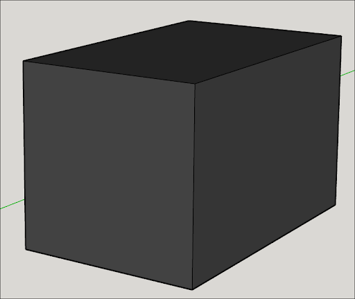

Style: Display in Shaded Mode
Uses basic shading to roughly simulate a light source.

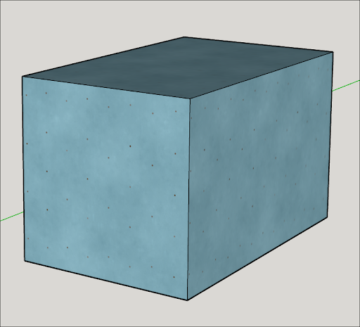

Style: Display Shaded Using Textures Mode
Uses basic shading to roughly simulate a light source interacting with basic textures.

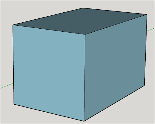

Style: Display Shaded Using All Same
Displays both the front and back of faces using the selected front face color.

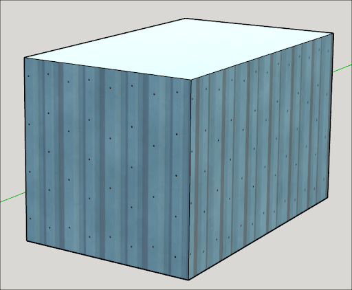

Style: Display Photoreal Materials
Displays faces using the Photoreal Based Rendering (PBR) texture maps assigned to its applied material. An Environment must be selected for PBR materials to display their full effects.

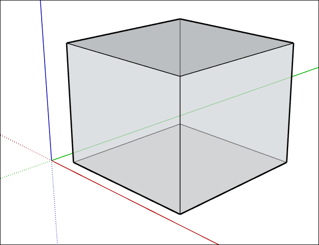

X-Ray
Activate to make all faces transparent. In this mode, you can easily visualize, select, and snap to points and edges that would otherwise be hidden behind faces. Faces cannot cast shadows in X-Ray mode. Can be activated at the same time as a Style setting.
