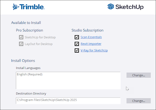

Users with a SketchUp Studio subscription can choose to download V-Ray for SketchUp along with other Studio entitlements in the Windows Installer.
