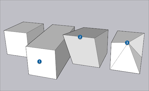

To stretch your geometry, select the Move tool ( icon move tool.png ). Clicking and dragging different parts of an entity will give the following results:
  1. A face – Stretches the entity while keeping the selected face intact.
  2. An edge – Stretches all faces adjacent to the selected edge.
  3. An endpoint – Stretches all edges and faces adjacent to the selected endpoint.
