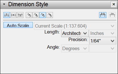

To format any dimension entity, you can apply shape, text, and dimension styles. This section explains the options you find in the Dimension Styles panel, shown in the following figure and found in the panel tray or, if the panel isn't on-screen, by selecting Window > Dimension Styles . For details about formatting dimension lines and arrows in the Shape Styles panel, see Customizing Line Widths and Styles . To learn about the options in the Text Styles panel, see Formatting Text .
Windows - Style Panel
Mac - Styles Panel
To start, select a dimension in the drawing area and open the Dimension Style panel. Here's a quick overview of your options:
  • Text position: In the upper-left corner of the panel, you can select from one of three buttons to position the dimension text box relative to the dimension line. Your options are Above, Center, or Below.
  • Text alignment: In the upper middle, you can select one of four buttons that align the text relative to the screen or the dimension line. Click the Horizontal or Vertical button to position the text relative to the screen. Select the Aligned or Perpendicular button to position text relative to the dimension line.
  • Dashes: In the upper right, the Display Dashes button toggles on or off the dashes that appear in dimension text. For example, by default, a dash appears between the feet and inches in the dimension 21'–2". Deselect the Display Dashes button if you don't want the dashes to appear.
  • Unit symbols: If a dimension displays only one unit (for example, only meters), you can toggle the display of unit symbols on or off by clicking the Display Units button in the upper right.
  • Scale: Click the Auto Scale Button to disable the automatic scaling feature and manually assign a scale to the currently selected dimension using the drop-down list. When Auto-Scale is selected, LayOut automatically uses the correct scale for an entity, depending on whether the entity is in paper space (2D) or model space (3D) :
    • For entities drawn in LayOut, the scale is 1:1.
    • When the dimension is in paper space (orthographic), SketchUp model entities use the original SketchUp model's scale.
    • When the dimension is in model space (Perspective view), SketchUp model entities use 1:1 scale. For these dimensions, the Scale drop-down menu is set to Not Scaled.
  • Length style and units (linear dimension only): From the Length drop-down list, select a format for the dimension length. Your options are Decimal, Architectural, Engineering, and Fractional. When a format enables you to customize the unit of measurement, the second drop-down list enables you to select an option, such as Inches, Feet, Millimeter, or Meter.
  • Precision (linear dimension only): Depending on the Length style you select, you can choose a level of precision for the dimension. For example, when the Architectural style is selected, you choose a level of precision from 1 inch to 1/64 inch.
  • Angle (angular dimension only): From the first drop-down list, you can select whether the angle dimension appears in degrees or radians. From the second drop-down list, select how many decimal points you'd like the dimension to display.
  • Extension lines: In this area, you can precisely control the length of the gap between the extension lines and their starting and ending connection points. To do so, make sure Gap is selected from the drop-down menu and enter a value in the Start or End box. To set different values for the Start and End gaps, click the chain icon so the values are not linked to each other. If you select Length from the drop-down list, you can enter a precise value for the length of the extension line instead.
