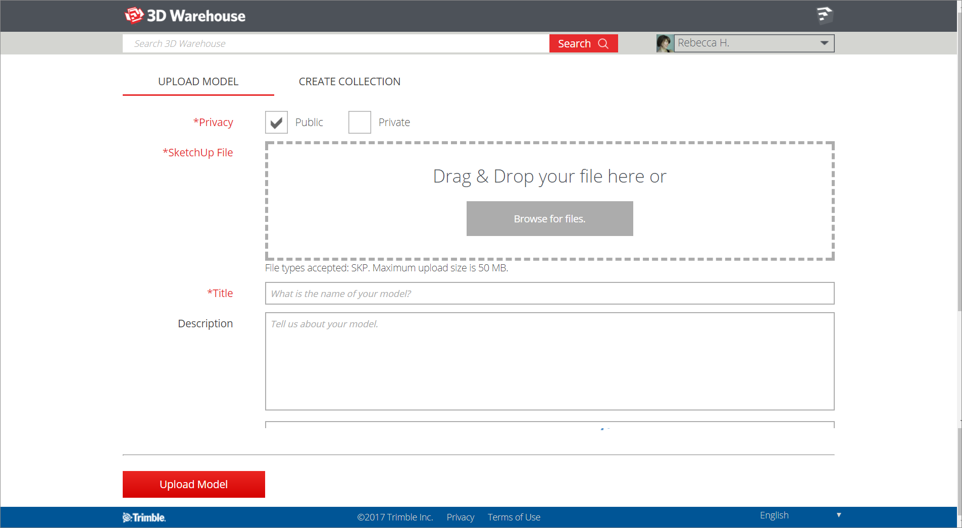

Uploading a model via a web browser
When you upload a model to 3D Warehouse via a web browser, you can upload a SKP file from any version of SketchUp.
Follow these steps to upload an SKP file via your web browser:
- Point your web browser to
https://3dwarehouse.sketchup.com/
and sign in to 3D Warehouse. - Click the Upload Model button at the top of the main 3D Warehouse page, or select Upload Model from the user menu.
- On the Upload a Model page that appears, as shown in the following figure, drag and drop the file you want to upload into the SketchUp File area. Or click the Choose a File to Upload button and select a file saved to your hard drive.
- Select a Privacy option and fill in the Title field. You can also add a description, URL, and a 3D printable file. See the list in the preceding section, Uploading a model or component from SketchUp, for details about these options.
- Click the Upload Model button. After a moment, you see the model details page for your uploaded file.

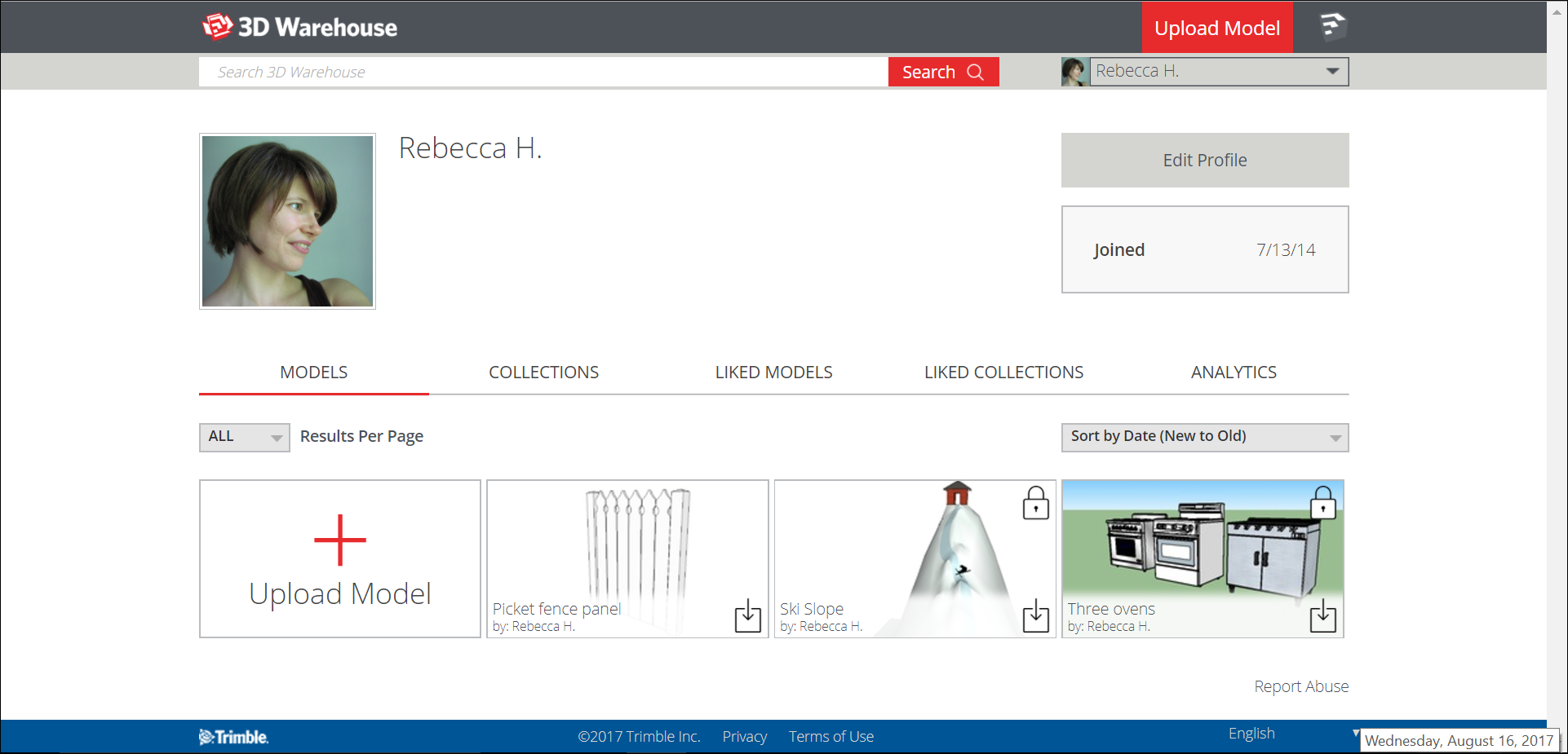

Viewing and editing your uploaded models
After you upload models to 3D Warehouse, you can easily find all your uploaded models on your My 3D Warehouse page. Simply sign in to 3D Warehouse and select My 3D Warehouse from the user menu. On the Models screen, shown in the following figure, you see all the models you’ve uploaded to 3D Warehouse.
From your My 3D Warehouse page, you can edit a model’s privacy settings and any details you provided about the model. For example, if someone commented about an issue with the model that you later fixed, or if you updated the model to add a new or improved feature, you might add that information to the model’s description.
Follow these steps to edit your uploaded models:
- From the Models screen on the My 3D Warehouse page, click a model to view its model details page.
- Click the Edit button in the upper right. (To delete your model, click the Delete button, and you’re done.) You can edit any of the options and fields that you filled out when you uploaded the model, as shown in the following figure. You can also have the following options:
- Replace the original file with a new one by clicking Upload a New File.
- Turn off commenting by selecting the No checkbox next to Allow Commenting.
- When you’re done editing the fields and options on the model details page, click the Save button in the upper right. A message appears, confirming that 3D Warehouse saved your changes.
