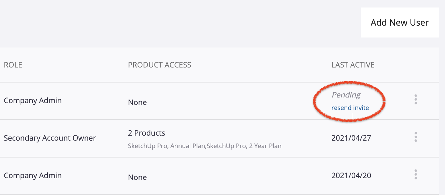

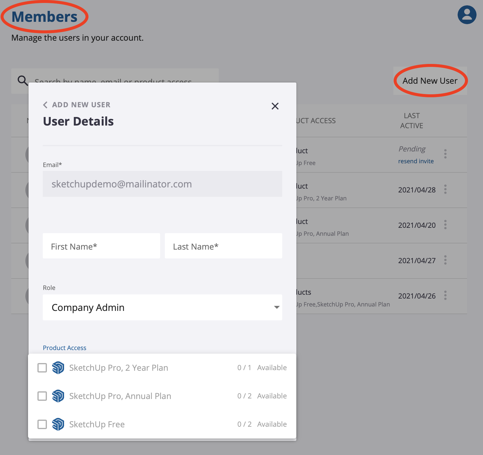

  1. Click on the "Members" menu item on the left lower menu of the Trimble Account page.
  2. Select your purchased plan from the top boxes. This is the step people tend to skip over if they have more than one box up there. Also, sometimes a Pro plan doesn’t just say Pro - it even might say something about a Rep or Channel and Renewal, but go ahead and click it anyway.
  3. If an incorrect end-user email is in the "Members" section at the bottom, then hover your mouse to the right of the email to activate the small X button to remove the current email address. If this email is the account admin email, it won’t remove admin privileges, just the SketchUp product access.
Most admins don’t need the search bar - it was put there for the company with 100 user emails, so they don’t need to scroll around when searching for someone.
Once you have a user seat empty, click the blue +Assign button to add the new end-user email address and name, and then click Add to finish this step.
You’re done! The end-user might need to wait a little while or sign out and in again in the software to trigger the change. If they haven’t created a Trimble ID sign-in account, they’ll be sent a link to create one, and it’s best if they click that link within 72 hours.
