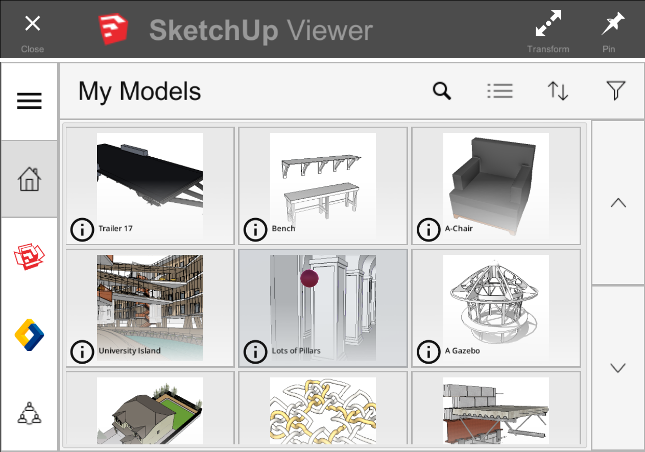

When you launch SketchUp Viewer, the Home Screen defaults to the Recent Models panel, as shown in Fig. 1 below.
Fig. 1. The Home screen opens to the Recent Models panel, which offers a mix of recently viewed files that might be saved locally on the device, or stored in Trimble Connect.

The Recent Models panel () displays recently viewed models. The models shown in this tab may be a combination of models that are saved locally on your device, or models that are stored in your Trimble Connect account. Models that live in Connect will display a Connect icon in the Model card (
Here’s what you need to know about this area:
- Tap the thumbnail or title portions of a model card to open a model,
Tap the Overflow menu button (
) of a model card to view additional options that are available for that model. For example, the option to delete a model that is saved locally (as shown in Fig. 3 below), or remove a Connect model from the Recent Models list.
3. The overflow menu for a model includes additional details and options.
