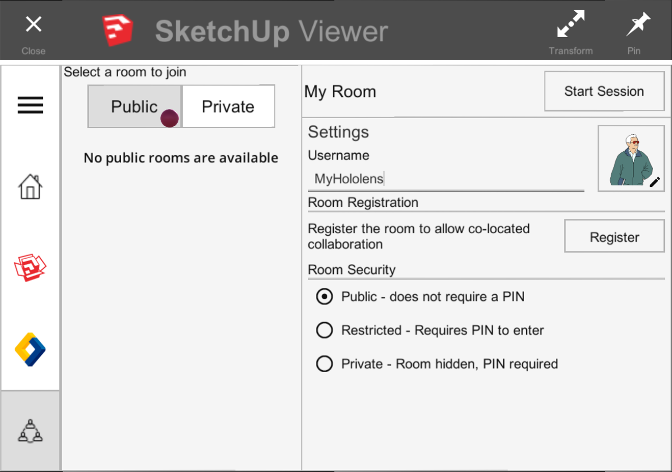

To collaborate with others, you start by creating a room. The person who creates the room is the presenter. To create a collaboration room, follow these steps:
  1. Air tap the Collaboration icon (image). You find this icon on the Main Menu, the Home Screen, and the Model Viewer toolbar. After you air tap Collaboration, you use the My Room area to define your collaborative workspace.
  2. Air tap Register to pick a registration point for the room. Registering a point will sync users in local rooms.
    Note: The person running the session chooses a point on a vertical surface, and all local collaborators can sync to that point. Any local collaborator who chooses to match the registration point sees the model in the same location. When a local collaborator chooses to register, they see an image of where the Presenter registered, so that they can match the point.
  3. In the Room Security area, choose what type of room you want to create. Here’s what your options do:
    • Public: Anyone running SketchUp Viewer can see and join your room.
    • Restricted: Other SketchUp Viewer users can see your room but need a PIN to join.
    • Private: Your room isn’t publicly listed, and users can join only with your PIN.
  4. Air tap the Start Session button at the top.

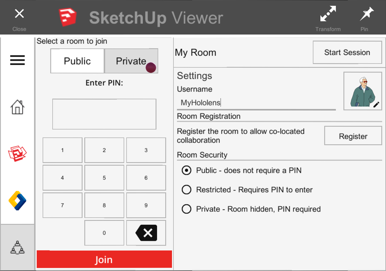

  3. Do one of the following:
    • If you chose Public, all public rooms will be displayed, and you can select the room that you wish to join.
    • If you choose Private, as shown in the following figure, you will be asked to enter the PIN of the room that you wish to join. Use the on-screen number pad to enter the PIN of the room.
  4. Air tap the Join button.

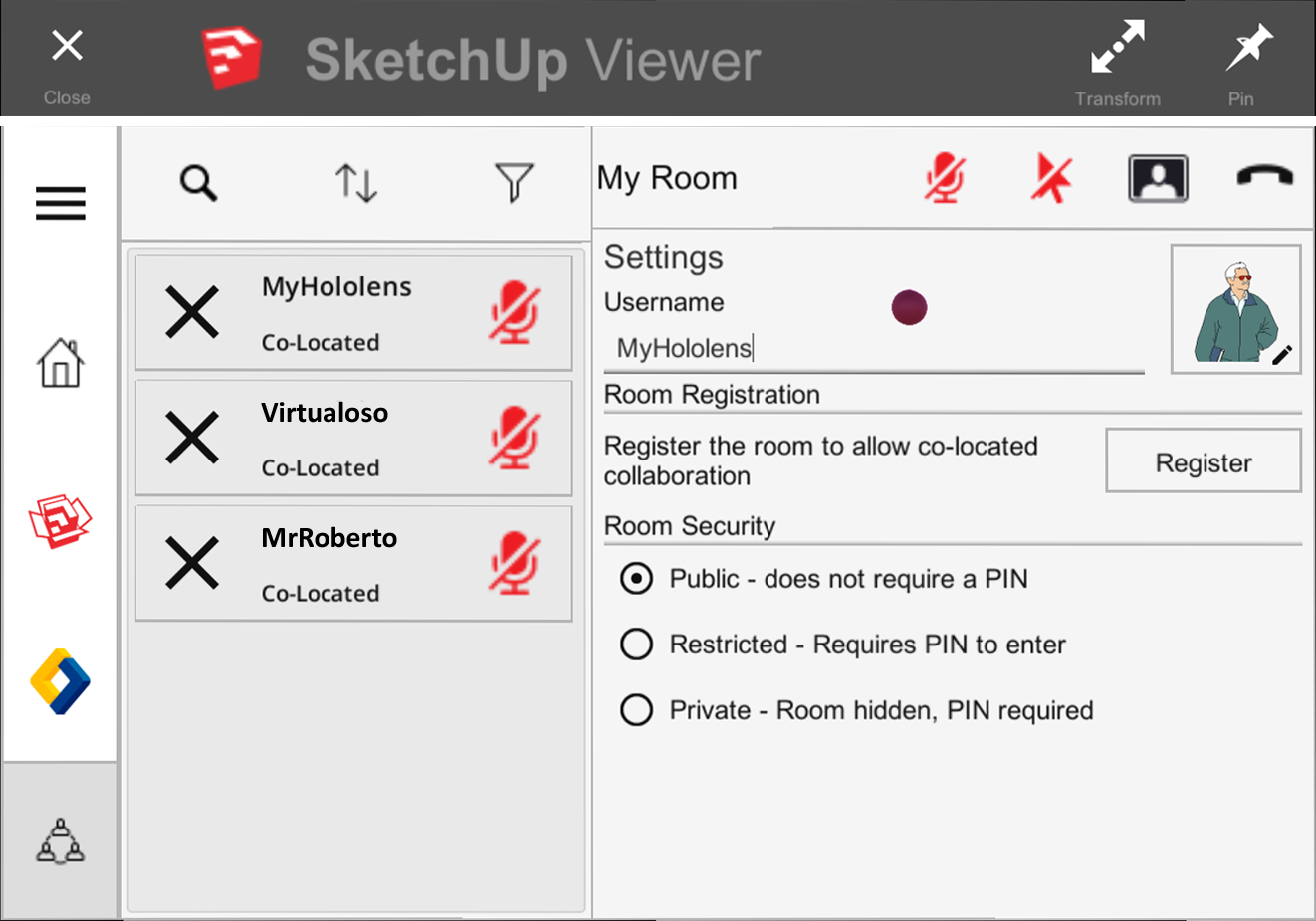

When you’re the presenter of a collaborative session, you have options that enable you to organize your session. You find these options on the Home Screen’s Collaboration tab, as shown in the following figure, or the Model Viewer toolbar in Tabletop or Immersive view.
You can join a public or private collaboration room in SketchUp Viewer for HoloLens
The following list explains the options and how they work:
  • To mute an attendee, air tap the microphone icon next to the attendee’s name.
  • To eject an attendee, air tap the X icon next to the attendee’s name.
  • To mute or unmute yourself, air tap your microphone icon.
  • To toggle your gaze on or off, air tap the cursor icon. Your gaze appears as a laser from the top of your avatar. Toggling off your gaze turns off this effect.
  • To close the session, air tap the Close icon.
