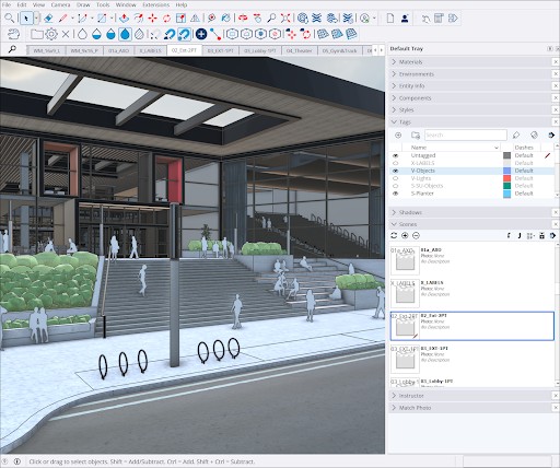

When you create a scene, a tab appears at the top of the drawing area, so you can simply click the tab to display the saved view. In the following figure, you can see how several views of the Victorian-style house are saved as scenes, with tabs along the top of the drawing area.

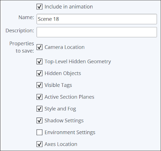

  3. (Optional) Click the Show Details icon () in the upper right of the Scenes dialog. Use the options provided to rename the scene (as shown in the following figure), add a description, and select which properties are saved with the scene. The next section, Managing properties saved with a scene, explains how the properties options work.

By default, when you add a scene, SketchUp saves several properties that affect the view of your model. In the Scenes dialog, the following checkboxes enable you to control which of these properties are saved. Here’s brief introduction to the checkboxes and the properties they control:
  • Camera Location: Remember that SketchUp uses a camera as a metaphor for the way you view your model. The camera properties saved with a scene include the the point of view, including the zoom distance and field of view.
  • Hidden Geometry: If your scene has hidden geometry, this geometry remains hidden every time you load that particular scene.
  • Visible Layers: This property applies if you use layers to control visibility.
  • Active Section Planes: Your model can contain several section planes, which slice your model at a certain point to display a view of the inside, usually from the top or the side.
    Tip: You can use different section cuts in successive scenes to create exciting animations of your model.
  • Style and Fog: This checkbox determines whether the scene saves style settings, such as edge rendering and fog.
  • Shadows Settings: This checkbox tells SketchUp whether to store all shadow-related information, including type, time, date, and so on, with the scene.
  • Axes Location: This setting affects whether the axes display and the axes' position in the scene.
By default, all these checkboxes are selected, so all the properties are saved with your scene. If you don’t want to save one of these properties, select the scene in the Scenes dialog, click the Show Details icon () to display the checkboxes, and deselect the checkbox for each set of properties that you don’t want to save.
