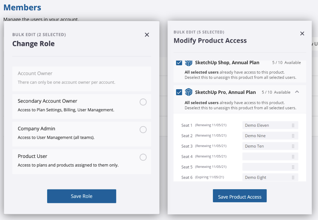

To change Roles and Product Access later, go to the Members page and select the members using the master checkbox or individual member checkboxes. Then select the Bulk Actions menu and choose either Change Role, Modify Product Access, or Remove Users.
Check or uncheck the products to assign/unassign, select the desired member Role, or select the members to remove, and Save the changes. The members will receive an email notifying them of the changes, and a link to their My Products page with access to their assigned product.
Handy Tip: Notice the grip-dots in the right side of the Modify Product Access image above? If you’d like to move a user to a seat with a different expiration date, you can drag and drop users to fill the different seats.
  • If you have more members selected than there are products available, then it won’t let you assign the product. Exit that menu, select fewer members, and then you’ll be able to bulk edit the Modify Product Access.
