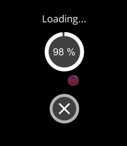

- Air tap the model that you want to open. Your model begins loading in HoloLens, as shown in the following figure.

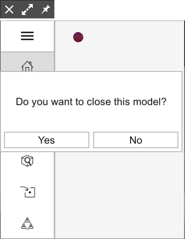

- Air tap the Home icon (
) to close your model. The viewer asks whether you want to close your model, as shown in the following figure. If you air tap Yes, you return to the Home Screen.
