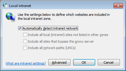

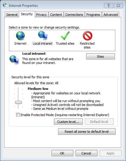

  • Update your Local Intranet Settings to check "Automatically detect intranet network"
    1. Navigate to the Control Panel > Network and Internet > Internet Options >Security tab.
    2. Highlight "Local intranet" and click the Sites button.
    3. Check "Automatically detect intranet network" and click OK.
    4. After making this switch everything should work properly within SketchUp.
