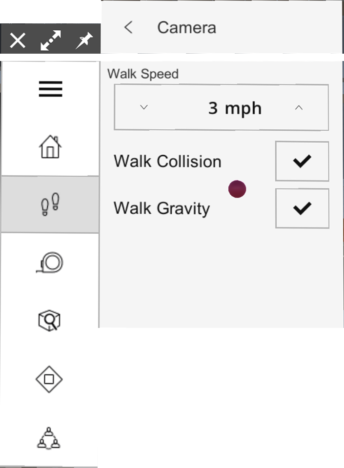

- To change your navigation settings, air tap the gear icon in the upper-left corner of the navigation options panel. You can adjust the following settings, as shown in the following figure:
- Walk Speed: Air tap the up and down arrows to change the speed at which you move through the model. The default setting reflects the average walk speed for a human, which is 3 mph.
- Walk Collision: This setting controls whether you can walk through surfaces in the model. If you want to walk through walls, air tap to clear the checkbox.
- Walk Gravity: This setting controls whether you fall to the ground after walking off a balcony (checkbox checked), or float like a butterfly (checkbox unchecked).
