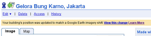

Your building's position was updated to match a Google Earth imagery shift.
This notification means that we detected an alignment problem with your building, and we automatically re-aligned it with the new imagery. You can check that it's correct using the View in Google Earth link on the model details page.

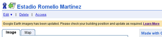

Google Earth imagery has been updated. Please check your building position and update as required.
In this case, we updated the Google Earth imagery near your building, but we were unable to re-align it automatically. We suggest reviewing your building's position using the View in Google Earth link on the model details page. If the position needs to be adjusted, please edit your model and re-upload it as a revision. We will automatically review it for inclusion in Google Earth.
